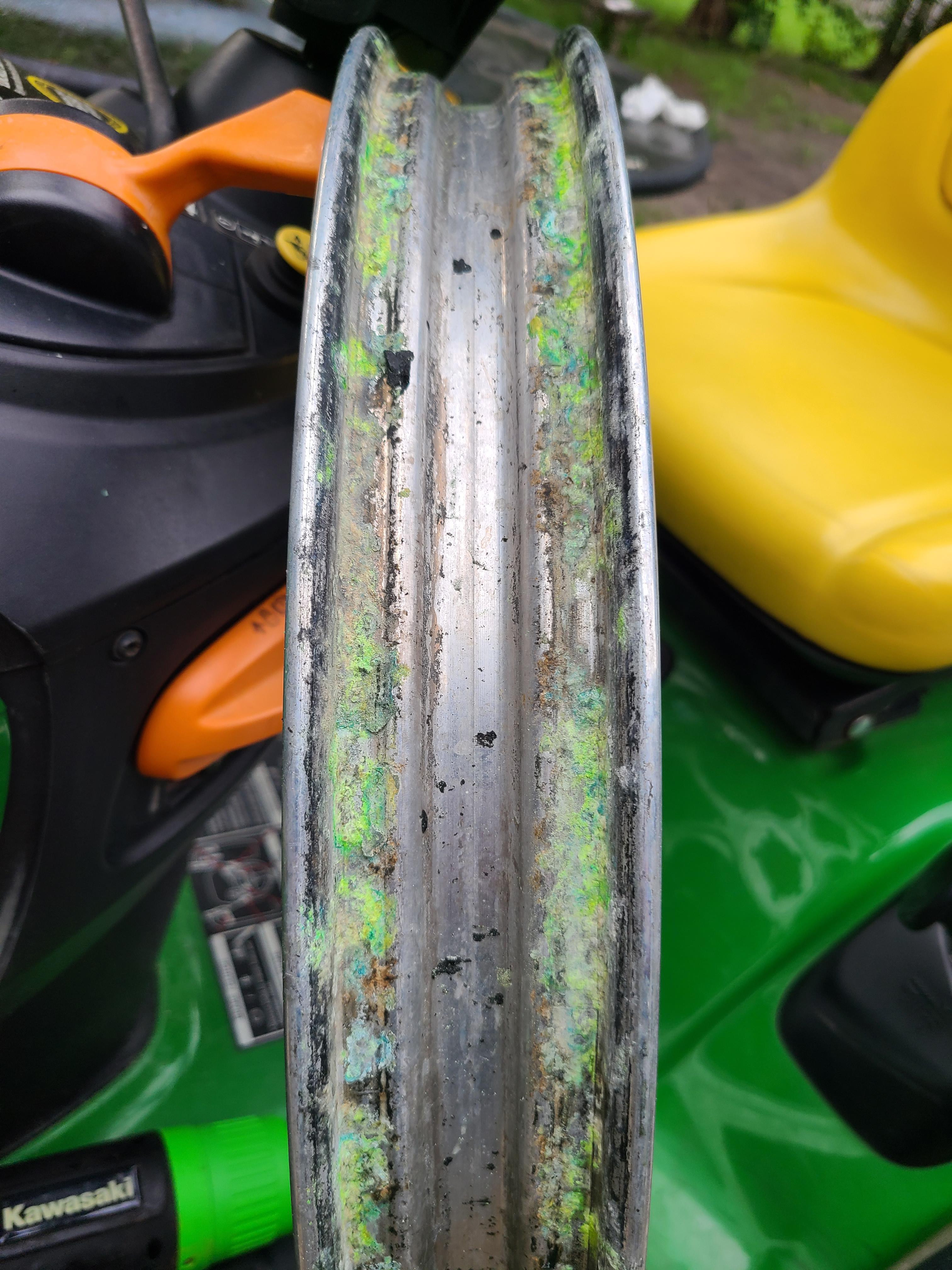

Removing dried slime from inside wheel
jarnett
Dealing with this. Anyone got any tips? Plan right now is simple green and scotch pads.

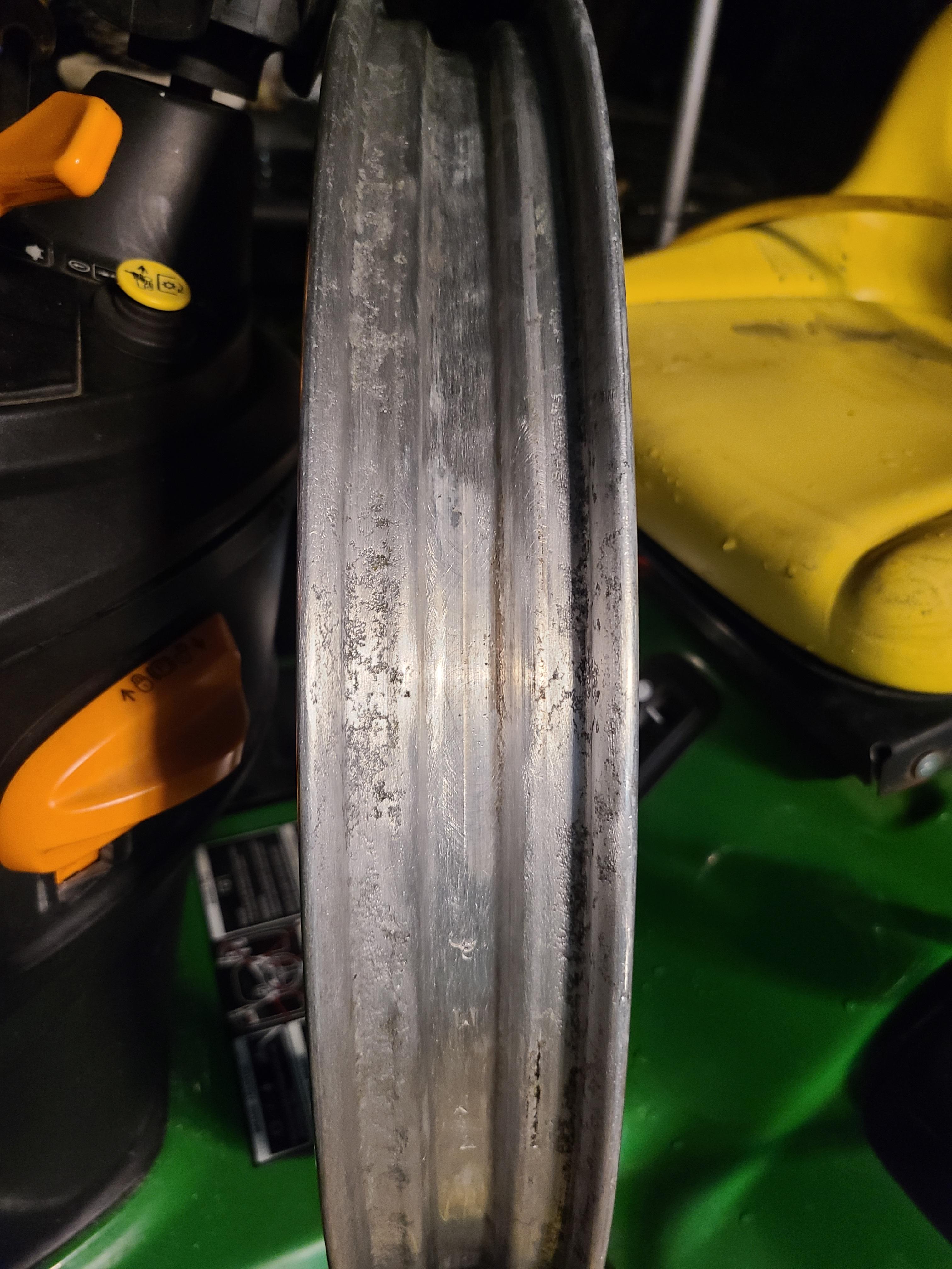

Tried pretty much every solvent I could find along with a scotch brite. acetone, goo gone, simple clean, vinegar, alcohol. Even tried warming it up with a heat gun nothing worked very well.
So I went scorched earth with a SS wire wheel and a drill. I realize it's not the safest method but hell it worked and the only real damage I see is pitted areas from the slime.
So this is what slime does to the inside of an aluminum wheel after its in there a while. I'll never use it again unless it's an apocalypse style emergency.

Way back in the day I had a business where we sold tire sealants. Slime was one of the ones we tested and it is very corrosive to aluminum.
