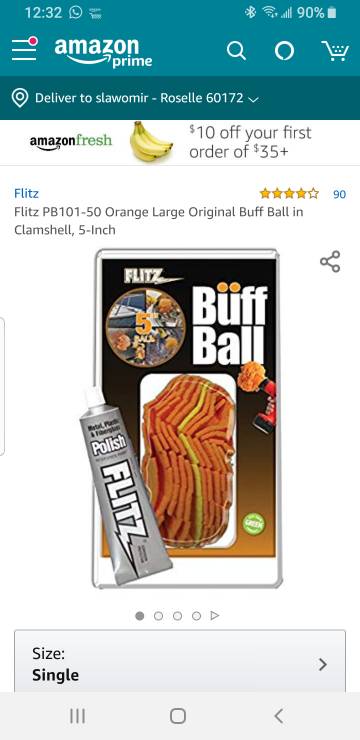

Hi - Can anyone recommend a product to polish the aluminum wheels so they look like chrome? I thought someone posted about it before but now I can not find the thread. Thank you
This is what I use for mine
Sent from my SM-G960U using Tapatalk
Mr. Wright
Lifetime Supporting Member
Flitz is good, but it's a lot harder to work with than good ol Mothers Billet. Apply it with a rubber glove, and let the polish do its job then wipe it off with a well used t shirt or flannel cloth. DO NOT USE A MICRO FIBER RAG.
