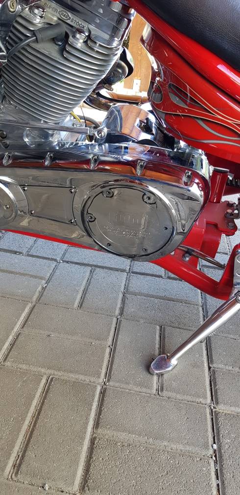

Adjusting clutch didn't resolve the issue, any other suggestions please?
Sent from my SM-N950F using Tapatalk
ElCapitano77
May have to pull the primary cover and check the clutch hub nut. They sometimes work loose and you can never get finial adjustment on the clutch.
Do I have to pull the whole thing off? Or only the gasket?
Dont have extra oil so I dont want to open it all and seems that the gasket is jammed in somehow.
Also, is it one nut inside (as all other bikes) or am I looking for something different?

Not sure what you mean with your question?
Do you have a service manual ?
You can remove the derby cover to inspect the clutch but you won’t have any room to do any work if required any may have to remove the outer primary to have room to work.
May also be a good time to change your primary fluid .
Get a service manual for your bike, there is a torque sequence when putting the primary back together.
Actually that cover doesn't remove gotta take the whole outer primary off on 05+. There is no way to even look in.

chapter 9 in the 2008 service manual which the link was posted in this thread details the process with pictures. If your already regretting this job you bought the wrong bike.
How did you adjust the clutch? I take it you only adjusted the nuts on the cable and didn't remove the small cover on the clutch actuator attached the trans, to actually adjust the clutch?
