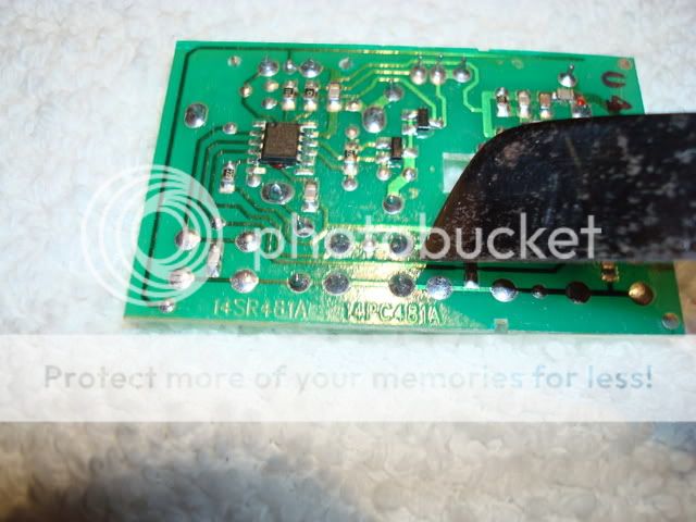

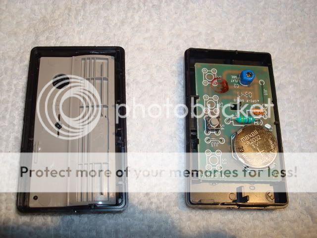

Open the case. Notice the button location on the left center of the circuit board. There are a dozen different opener brands but they all work similarly and have some type of small button inside.
Here's a close-up shot of the button for mine.
Then, turn the board over and locate the soldered contacts for the push button. Short them together to be sure which two they are. It should trigger the door when you short the correct contacts.
Strip back 1/16" of insulation on both conductors of a piece of speaker wire about 24" and solder them to the two contacts with a pencil style soldering iron.

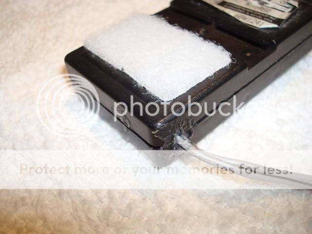

Cut a small slot in the door opener case for the wire to exit and route the wire to the slot, snap the case back together and silicone the hole to keep moisture out. Here's what mine looked like.

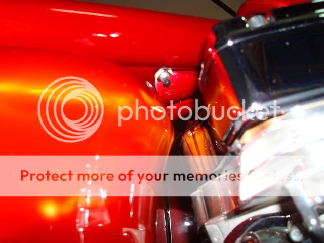

At this point, you should locate your preferred mounting location for the opener and the switch so you'll know how long to cut the wires. I applied velcro and stuck my opener to the side of the EHC and mounted the switch next to the seat bracket where it could be pressed easily if you know it's there, but yet out of sight.

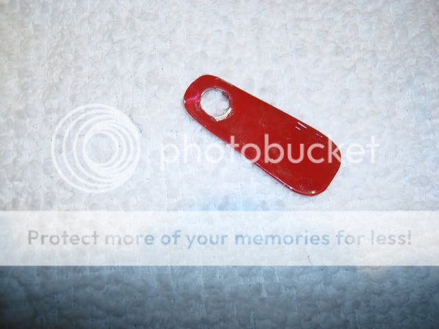

Next you'll need a mount for the push button. Something metal that you can shape easily to fit into the location of your choice. I cut an oval out of an old license plate and painted it candy red to match my bike. Painting is certainly optional since you most likely won't be able to see it anyway. Here's mine with a 3/8" hole drilled to accept the switch.
Switch mounted

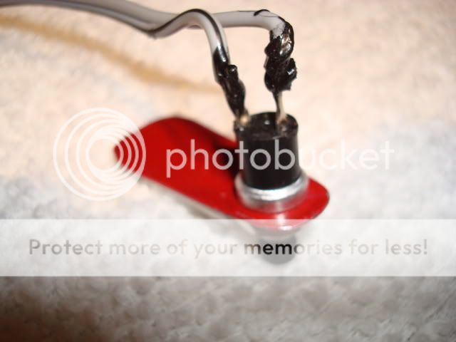

Now, strip 1/4" of insulation from both conductors and solder them to the push button. I painted the ends with liquid tape to insulate it from possibly grounding against the bike. Here's the end result.
You should now have a garage door opener wired out with a remote switch on a metal tab.
Now, just velcro the opener to your predetermined location.
Clean off the mounting location for the push button with some alcohol, put some double side tape on the push button mount, peel off the back side of the tape and press into place.

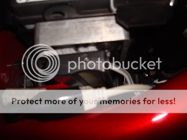

When finished, you can't see the switch unless you look from under the bike and know where to look. This shot is taken from the right side of my bike looking up from the exhaust pipe.
