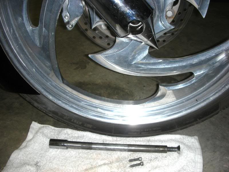

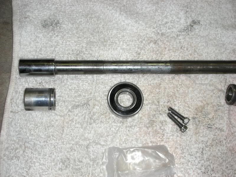

First thing I did was remove the pinch bolts and axle bolt. Then gently tapped out the axle. It was in great shape with no rust considering I've done a lot of riding in the rain. Those outer seals work pretty good.
Then gently slide the wheel out and remove the spacers and place them back on the axle or in the proper place so that you know which side they go back on as they are different sizes.

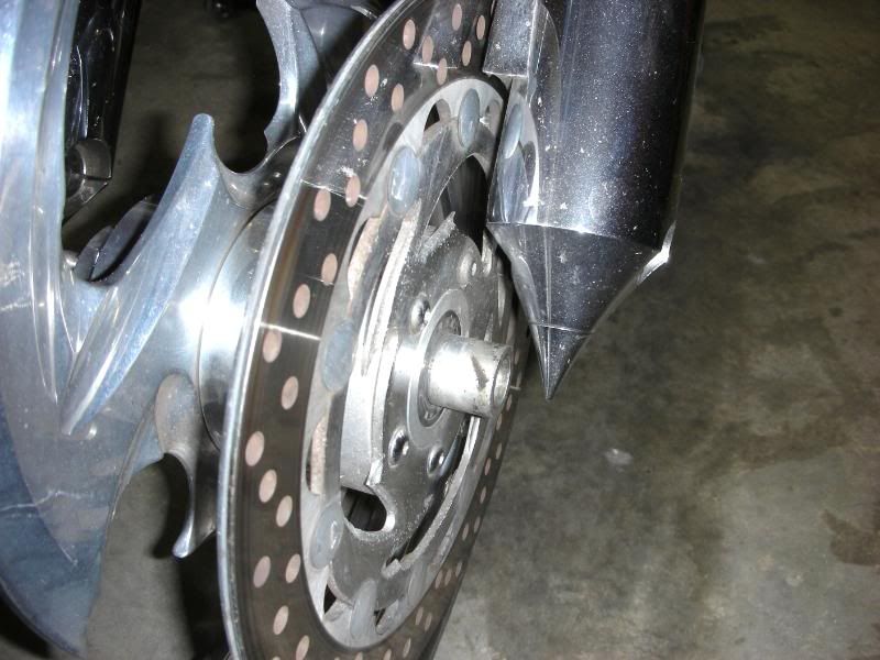

Now remove the rotor/disc. This allows access to the 5 hub bolts that need to be removed to change out your bearings.
To remove the hubs you will need a long hex socket. My Snapon wasn't long enough but my MAC socket was.

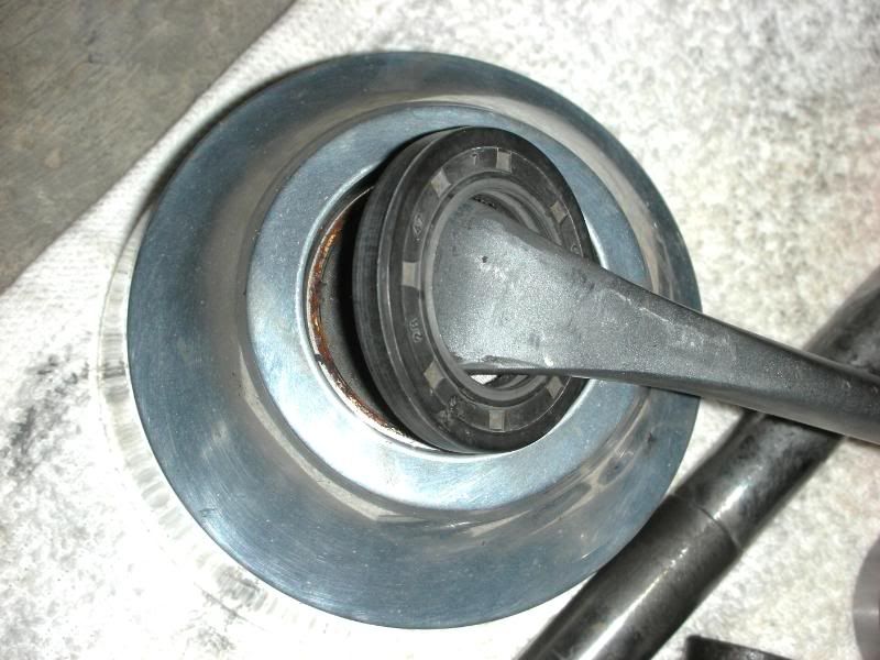

Next I popped out the outer seal from each hub with my tire iron.

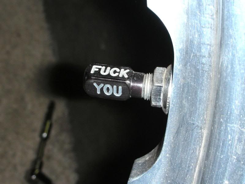

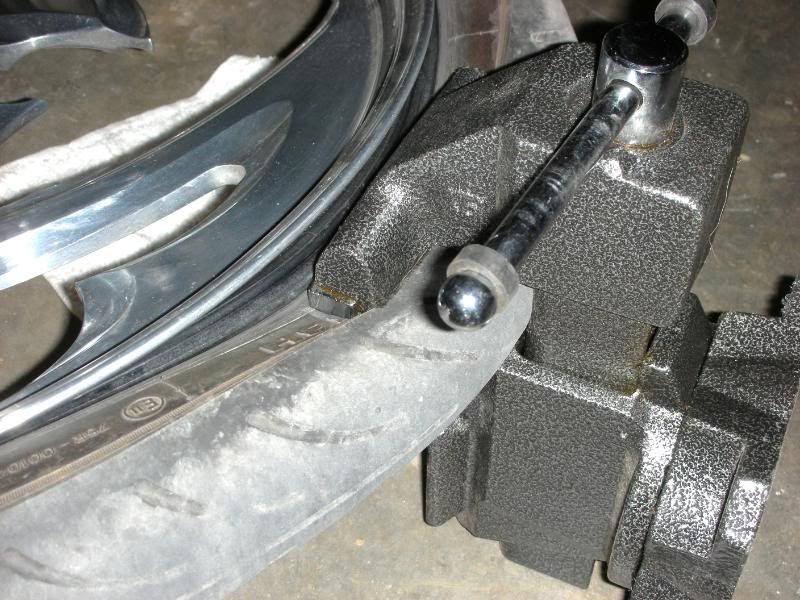

Moving on to the wheel and tire. I first removed the cap and valve core.
Then using a small vise I broke the bead of the tire. I was able to step on the tire with my feet on the last tire I did but this one was stuck so had to use the vise.
Then using the tire irons and rim protectors I popped off one side of the tire. You can spray the tire beads with WD-40 and it will help. Notice the Dyna Beads all over. Also some of them turn black.
Then you can pull the rest of the tire off the wheel.

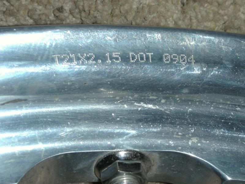

Here is the rim stamp. My wheel was produced in September of 04 and I bought my bike in October of 04. I have the 29th Chopper produced.

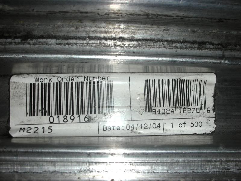

Here is the bar coded work order label inside the rim.

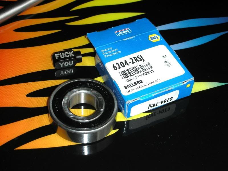

Well I learned a valuable lesson today. I got my hubs back from the local shop that popped out the old bearings and put in the new ones for a 12 pack.
Got home and started to put everything together and though to my self. "You know I should check those bearings" so I grabbed my axle and stuck it in the bearings and it was sloppy loose!!!
Turns out the NAPA bearings are 40 thousants off. So called my dealer and they have them in stock and sending them to me. We only have one dealer in Washington and it's a 6 hr trip for me. My local shop still hasn't get them in so the hell with them.

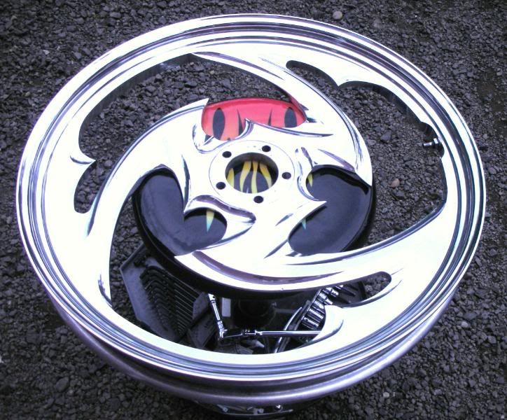

Have a very shiny wheel now with some polishing tools and a little elbow grease. Wheel and hubs are worn bad from gravel, sand, bugs and whatever else I've ran through over the past 4 years.

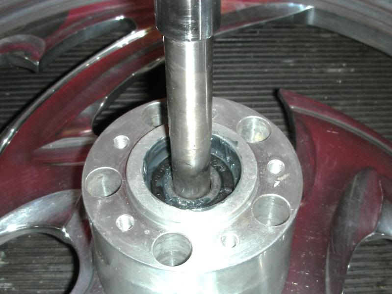

Here are the old ones. I guess this is why they require we replace them every 10,000 or at least thats what the 05 manual states. The one on the right is the brake side:
After getting the stock bearings from my dealer I had NAPA Auto press them in. They also refunded me on the wrong bearings they gave me last week. Just for the hell of it I decided to pull the seals on the new bearings and this is what I got!!!

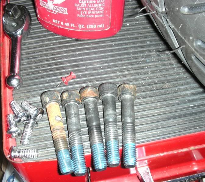

I add loctite to all the bolts here. The manual states to use red but for the large bolts I used 242 and used 271 red on the rotor chrome bolts:
You may remember in a previous thead we talked about "Torque" values on these bolts. I posted where my manual states 50 ft lbs! Well I about ruined the chrome rotor bolts cause you can't get 50 lbs on those hex head cap bolts with out stipping the hex head. Now I will have to order another set of chrome bolts. Dogvet posted in the same thread that they were something like 25 lbs so that is what I used along with the stronger red loctite.

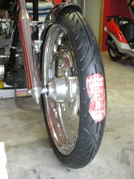

The rest was a reversal of the dis-assembly. I lined the wheel up to the forks after I used my tire iron to press the brake pads out a little. Then inserted the spacers and slide the wheel in place. Then I carefully lower the bike till the fork lined up with the hubs so I could slide the axle in. I greased down the axle for good measure then put the axle bolt in and torqued it to 45 lbs then 12 lbs for the two pinch bolts. Then I jacked it up again and spun the wheel and listened for anything that may not sound right. Everything seems fine so I dropped it off the lift and took her for a ride.
Night and day difference. :2thumbs: :2thumbs: :2thumbs:
