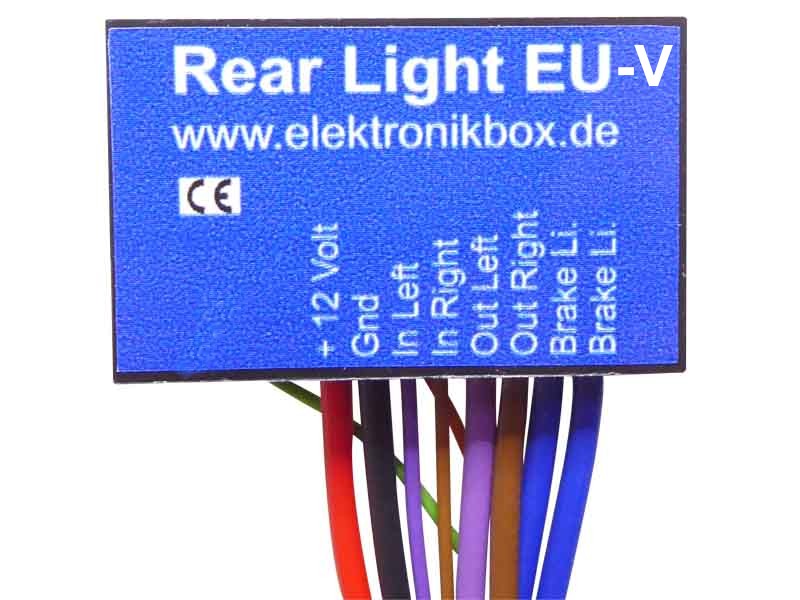

You just need to change the led rear inserts against amber an red inserts, cause here in Europe we have amber led´s for the direction indicators and red led´s for the brakelight / rearlight. You also need a converter for the rear light what divide the brakelight / indicator signal in 4 separate signals. You can get it from me or from Curtis / Wild Steed. You´ll find more infos at:
However, you don´t need the converter if you have installed an aftermarket EHC from me. In this case you can change the settings of the EHC to "EU mode".
