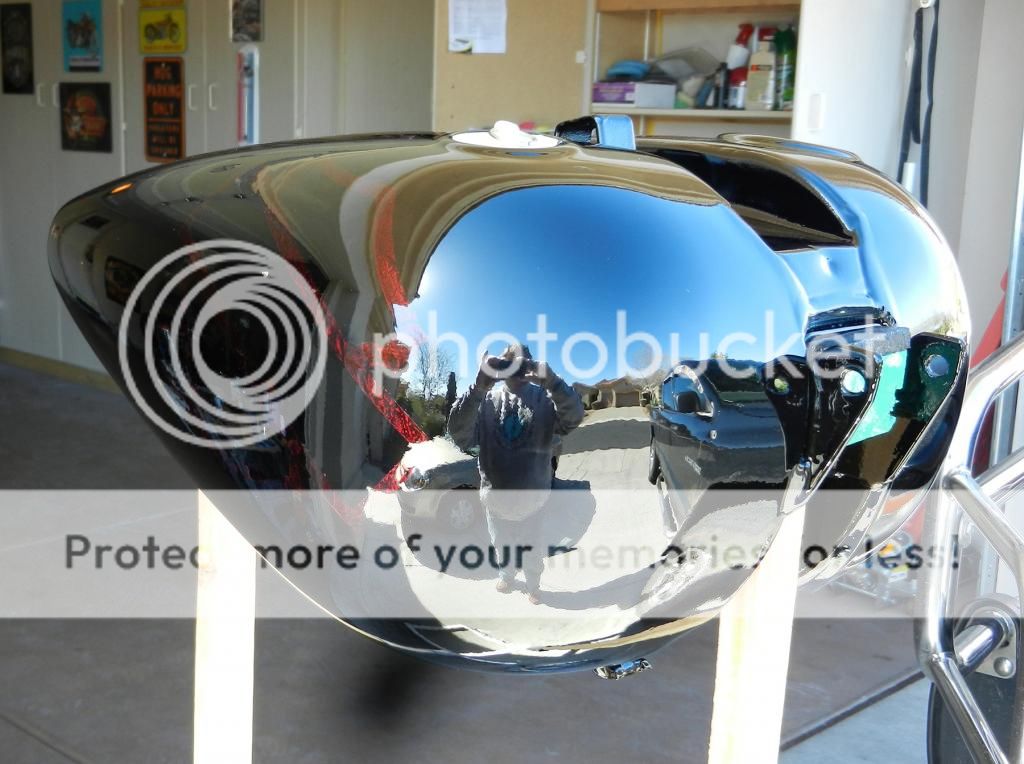

Here are a few pics. In normal lighting the logo is somewhat visible:

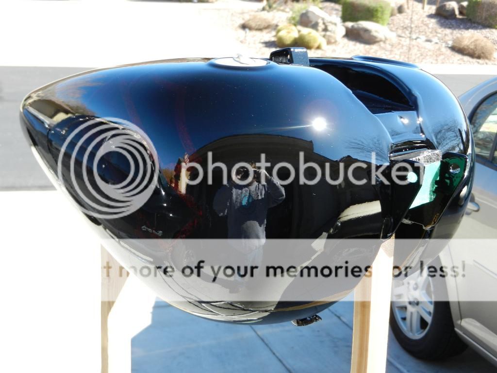

With more light, the graphic starts to become noticeable:
In bright direct sunlight it can be seen:

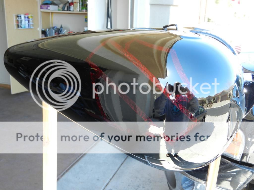

Mostly though, it appears black:

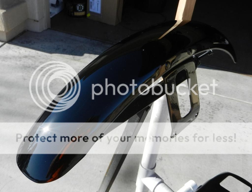

Here are the fenders:
