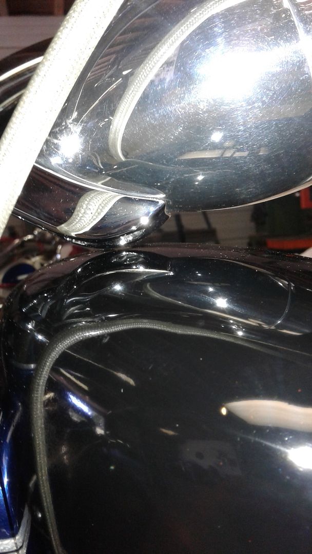

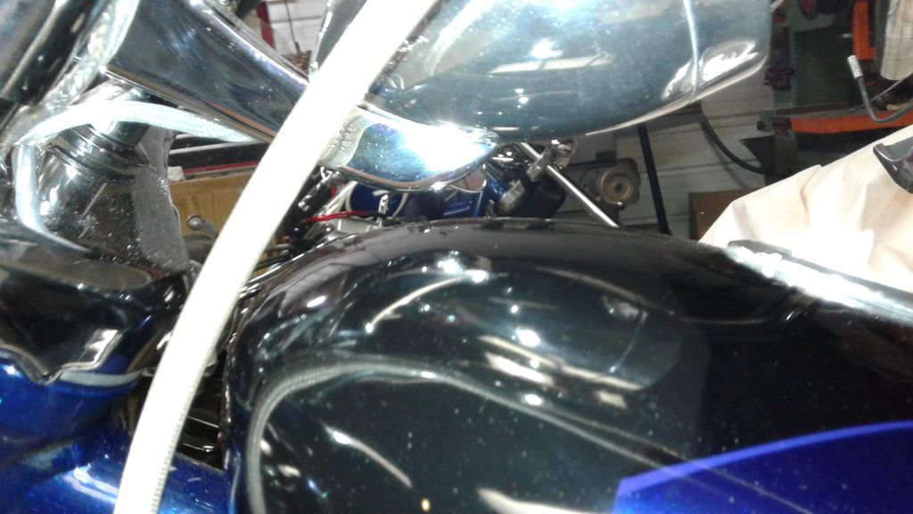

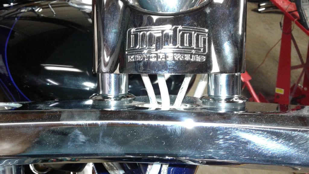

I did this to Shain's bike. You'll have to change to brake line, throttle cable, and clutch cable. The Kaptin has the wire kit, so you don't have to splice the wiring. I did run into a couple problem. First the speedometer bracket wouldn't clear the tank.
So I had to add 3/4'' spacers under the handle bars.
This gave it about 3/8'' clearance.
They do come back further, and look nice.

If they make a shorter bracket, it would bring it up off the tank, but I don't remember if there is enough room between the speedometer and the handle bars. Maybe Blacktopper will that a picture of his set up.
