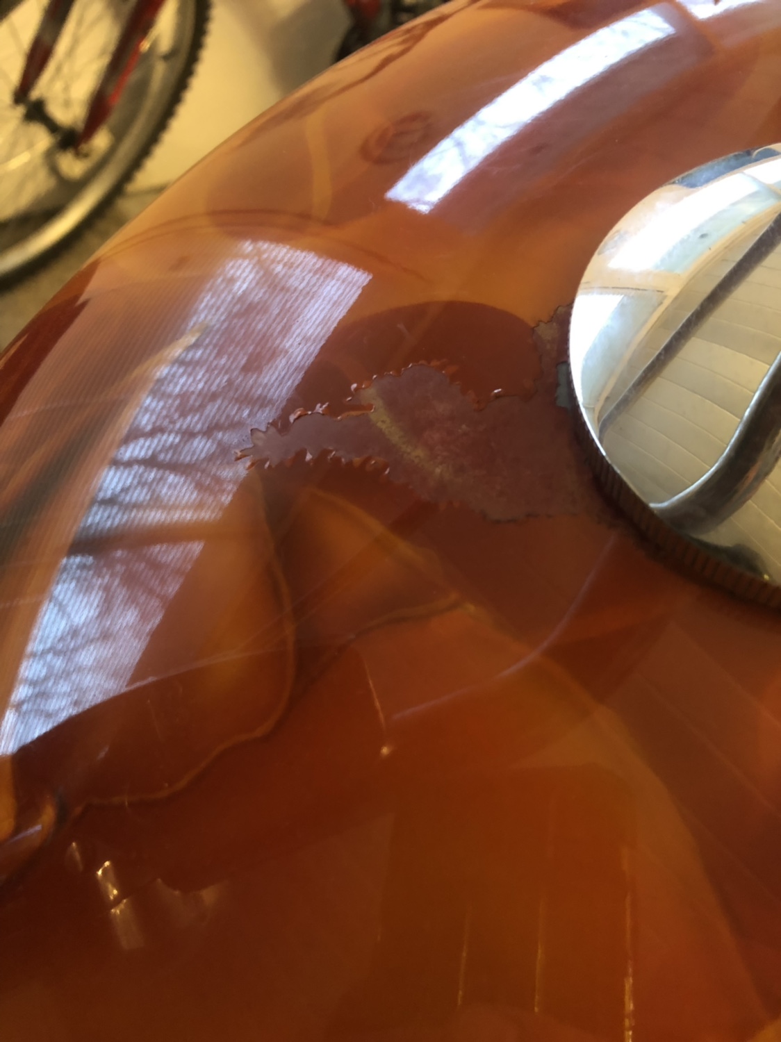

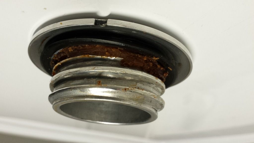

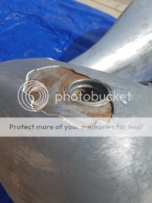

YES!
If caught in the early stages --it can be saved!
If let go -- well you see what happens...
Take that gas cap flange off and see what is under there; and never do it that previous way again!
Looks like you gotta repaint the whole tank to make it nice again...
Check it out:
http://www.bigdogbiker.com/threads/install-repair-gas-cap-paint-saver-bubbling-paint.78828/

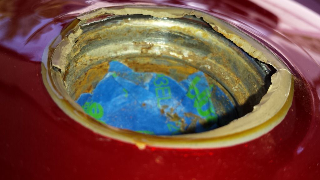

I had the misfortune of getting an expensive custom paint job by so called experts that failed miserably within days; from paint bubbles around the gas cap.
This was caused by gas or gas fumes getting under or between the paint and underlying metal gas tank because the rubber gasket was used improperly, with improper adhesive.

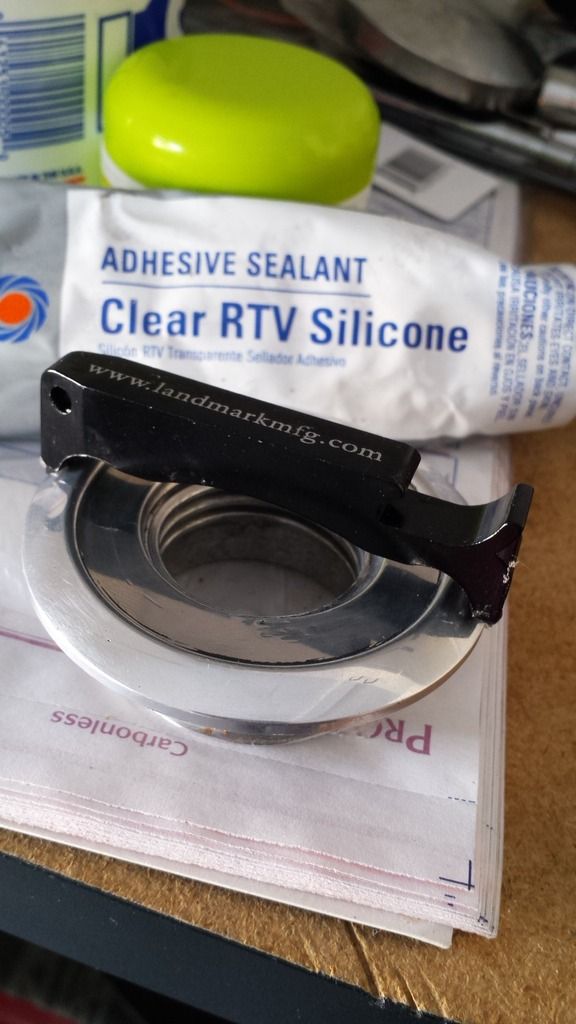

1) Remove the stock Landmark gas cap
2) Remove the stock Landmark Paint Saver Ring screwed into the gas tank with the
SPECIAL Landmark REMOVAL TOOL (not shown).
2a) Landmark Removal Tool
3) In my case the Landmark paint saver ring was installed incorrectly with the rubber gasket (badly worn and not the same style as provided by Landmark) see photo below.
4) Clean up any loose material and block pieces from falling into tank with tape…

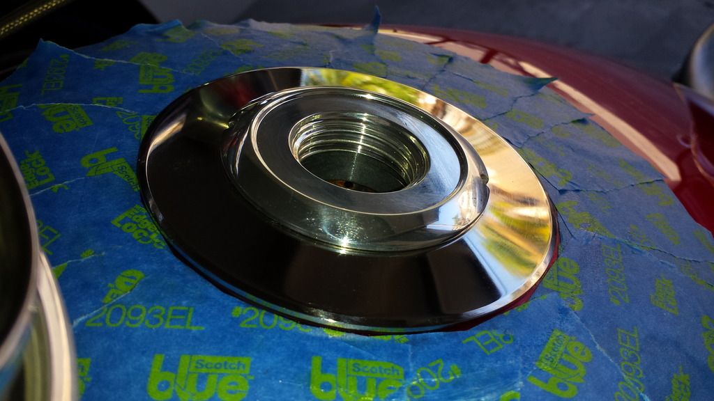

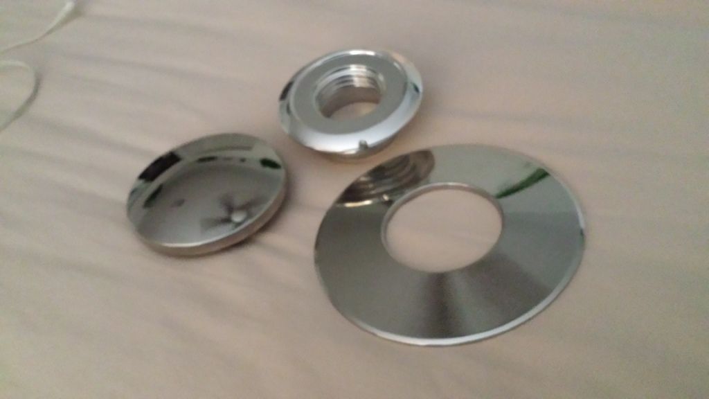

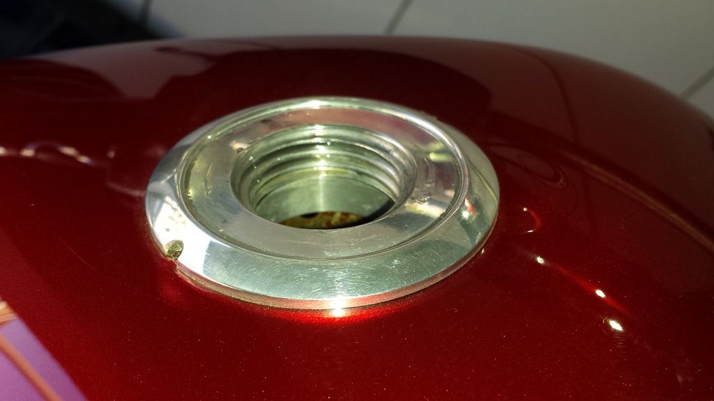

Contact: “MR. Wright” of this Forum to have him custom make you an oversize paint saver ring to fit your situation out of stainless steel stock. (about $35.) see below lower right in photo.
7) Dry fit all to be sure of the look and fitment, bend, etc, will work…
8) Place masking tape around area to cover where you do not want RTV silicone to go and keep it neat.
9) Assemble with RTV Silicone glue (I used clear) on the gas tank threads and top edge; then put RTV Silicone on underside of large MR. Wright ring. Place on tank wipe excess oozing off inside of tank; masking tape dam will block from falling into tank.
10) RTV silicone up the smaller Landmark threaded paint saver ring and screw in to tank threads through center of the larger MR. Wright paint saver ring.
DO NOT USE THE RUBBER GASKET! Or it will leak…
11) Tighten Landmark paint saver ring with tool to very snug fit or in my opinion what would be about 30 ft. lbs. of torque. The RTV Silicone will ooze out everywhere --a good thing, and wipe excess to clean up.

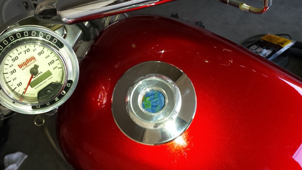

Recommend:
WAIT 3 FULL DAYS TO DRY WITH TANK GAS CAP OFF, NO GAS IN TANK ! in well ventilated area.
After that gas up; never fill past inside metal lower neck of tank. (As I knew from my early teens on any bike-- and you probably do too).

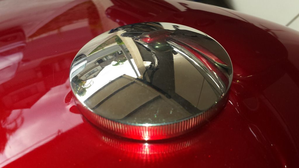

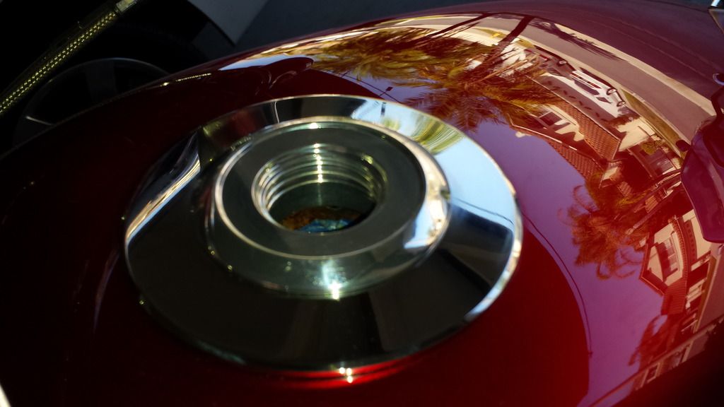

What I like:
The new larger Mr. Wright paint saver ring prevents scratches in paint from finger nails and gas nozzle flex boot (in California gas pump nozzles) may scratch paint.
This fix has worked now for 4 months and 10 tanks of gas. A lot less expensive than new paint and I believe it is a much better set up than stock.

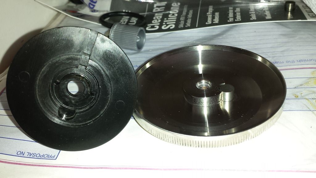

I also bought a brand new Landmark Gas Cap (vented as original) with paint saver and removal tool included ($95.) Got it in one day since Landmark is in Oceanside, California 20 miles down the freeway.
http://www.landmarkmfg.com/
Gas Cap dis-assembled below to show vent and inspect...
PS: the above repair done Nov. 2016 and as of June 4, 2019 all working great!
31 months now and at least 70 tanks of gas...
