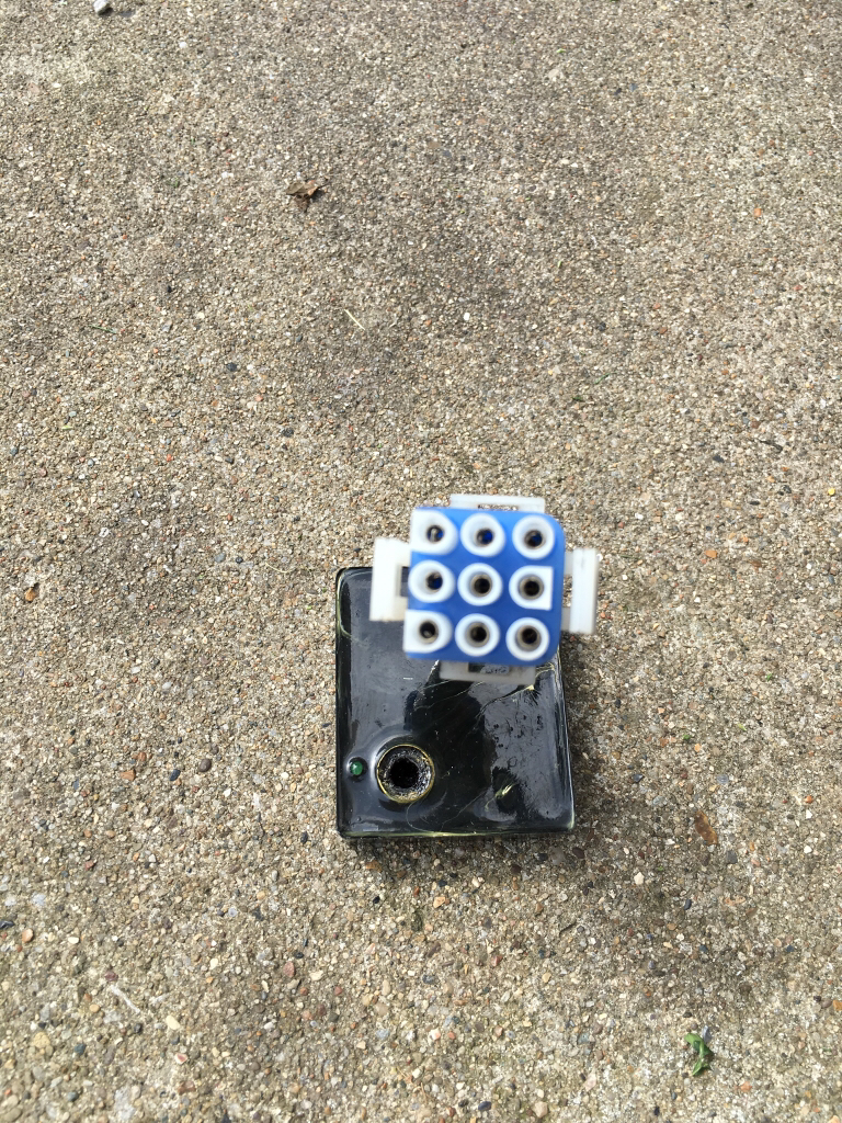

    Yes i am certain its the module. My ground on the battery came off and shorted it out. I can smell it burnt. If u could do that I would be so grateful.

    [​IMG]here is mine

    Nope different connectors... Sorry man.
    I was hoping someone could use this damn thing too been sitting on my shelf for almost a year.
    I didn't even realize WP made a 03 big dog unit until now..lol

    It's got more wires coming out then you got there. Mine has two plugs it's also setup for momentary switching not latching. Since I have push buttons on my 04 controls and you have the Harley style rocker switches. I'd say these are not compatible.

    Your right. I didn't realize 04 had the new switches. I really appreciate you taking your time to check. Thanks anyway. That would have bn awesome.
