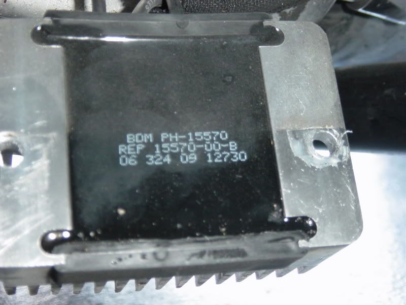

The VR recall effects all 2005 and some 2006 dogs. There is a HUGE and LONG back order on the VR. So if yours is one, the sooner you get in the claim the better.
Here's how you find out if you're VR is a bad dog.
Remove the 2 - 7/16" hex bolts holding up the VR under the front motor mount. Of coarse this is on my 2006 chopper so location may vary.
Then look at the back of the VR. There will be 3 rows of numbers/letters. On the third row the first two numbers
04 & 05 = bad dog
06 and greater = good dog
As you can see because I had my VR replaced in March of this year I'm all good!
Hope it helps.

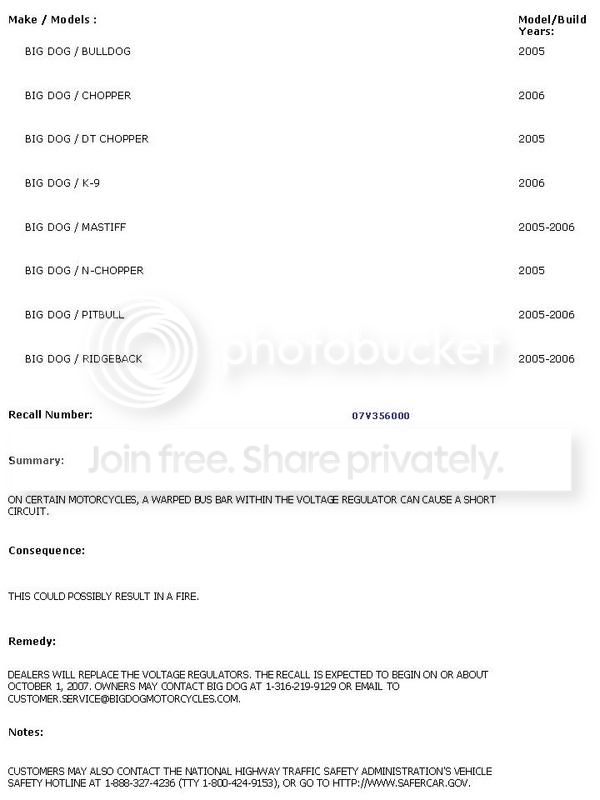

The info from Fibersnake...
fibersnake said:
Just saw on another site that BD has a new recall out for many models from 2005 and 2006. It is for the voltage regulator on some of the models.
It appears that those effected will be getting letters soon for the recall is expected to start around Oct. If you are in to the stealer and have one of the possible models, now may be a good time to hit them up and get it out of the way (if yours is one) instead of waiting.
Here is the info link to the NHTSA
http://www-odi.nhtsa.dot.gov/cars/problems/recalls
Just drill down through the sub menus to get to the Big Dog. The recall number is 07V356000
Here is a basic overview snapshot of the issue

VR recall - new correction
Well - now that all of you have been waiting months for the elusive new voltage regulators from BD ( and the HD parts won't work - they're only 32amp) they've gone and changed the fix. :bang: Evidently the VR isn't the source of the issue, the circuit breaker is. We did a repair on what I know to be the first bike to suffer the fire :angry: from the failure... and a few since. We're looking at installing a new circuit breaker now - luckilly there are plenty available... almost. All us dealers get 10 at a time. We're supposed to recive 10 kits on the 7th of December, as are many dealers. Thanks to Raywood :2thumbs: for giving me a call about this so I could straighten it all out with Big Dog. Now... I'm off to have a Guiness or 3 - have a great weekend! :cheers:
