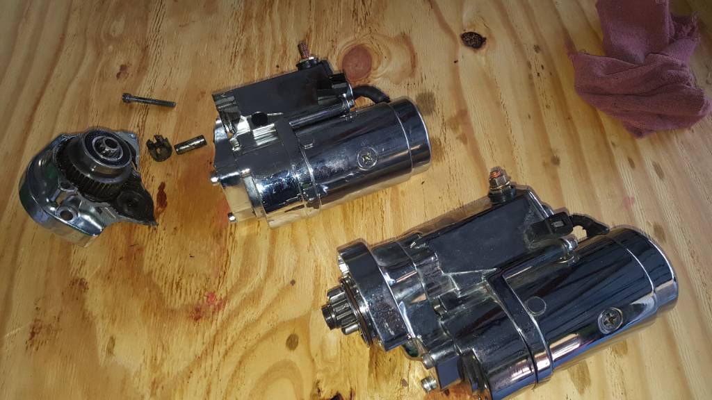

    be aware that adding compression is hard on starter system.
    I have put in two starters (broken parts), two compensators, and three starter clutches in my "high compression screaming eagle 103 kitted Fatboy.
    I have put nothing but a battery in my stock 107 Pitbull.
    Unsprung, chubs and pknowles like this.

    Whaaaat???? Never!!!
    chubs likes this.

    Snapped in half.. lol[​IMG]
    chubs likes this.

    well, after fixing the sumping problem, and touching every part on it ( sometimes with a wrench, sometimes with new connectors)
    the pit has been trouble free, Only problem I have with it is bumps/holes in the road. :chopper:
    chubs likes this.
