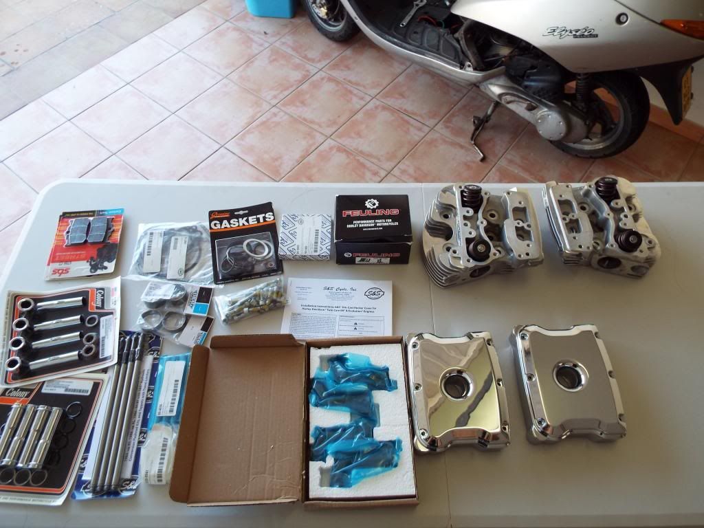

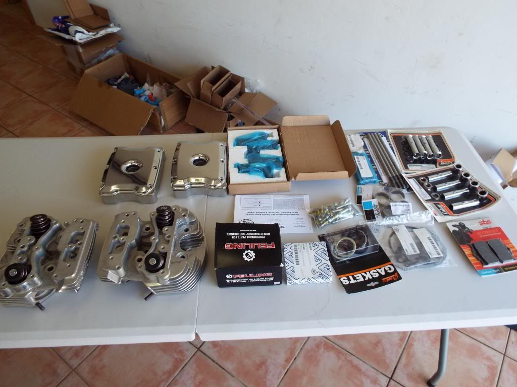

    Here a couple pics of mine when I first lifted the rocker boxes:
    Here the S&S new gear: :up:
