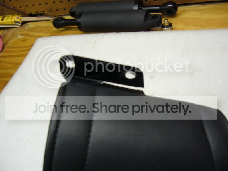

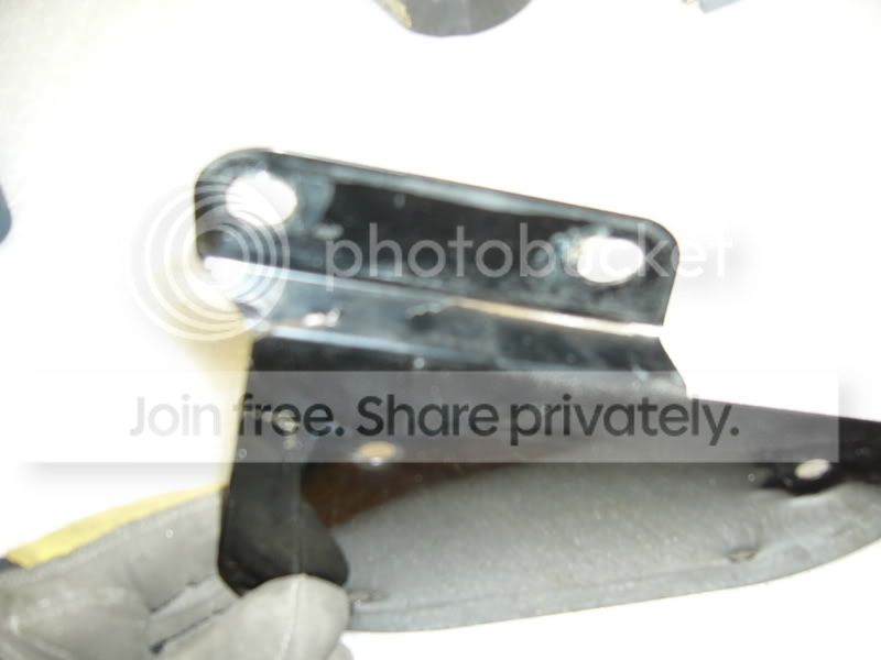

    OK, so I'm noticing my left stash bag is feeling loose. So I feel up in there (it's as tight as a twelve-year-old between the bag and the frame), and sure enough, there's a nice old crack along the second bend.
    Here's a couple shots of the crack. There was rust in the cracks, so it had been there for a while.
    Pretty flimsy build, so I break out the 16 GA steel and start to work.

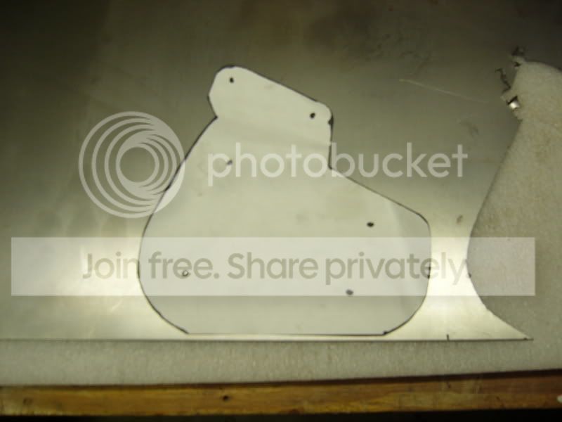

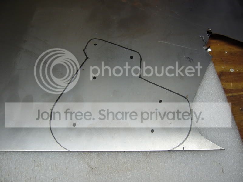

    First I made a template of the bracket and transfered it over to the steel.

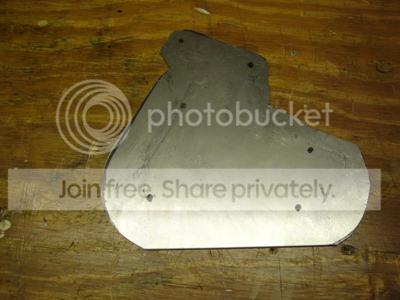

    Then jig out the template and mark your holes.

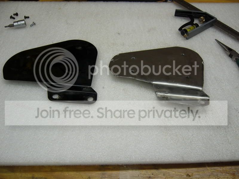

    Then put some temp bends in and rough fit it to the frame. Your basically putting a big flat washer between the strut and the frame, so you want it to be as flat as you can get before clamping it down.

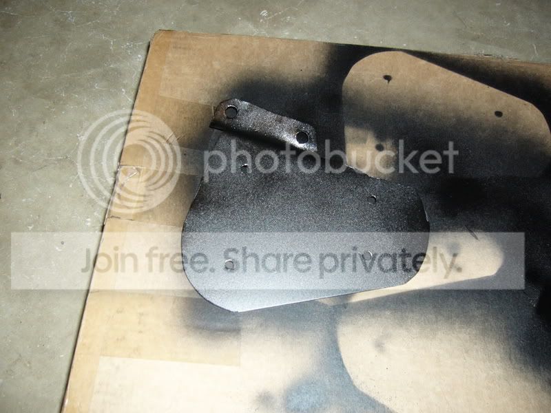

    Slap on some paint (I like flat black Rustoleum for these kind of things)
    And mount her up;
    I garrentee there ain't gonna be no cracks in that bracket no matter how much she shakes! If you got one of these, it may be worth taking a look at your bracket. I had around 6,000 miles on that bracket before I noticed the problem...
