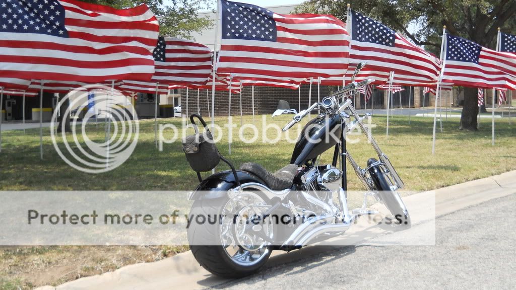

    i had a guy that works at a gun shop mill and tread the end of the cartridge. just hope i never get rear-ended.

    Thanks Noodles, out here is west Texas the wind always blows so was lucky to find all the flags at full mast
