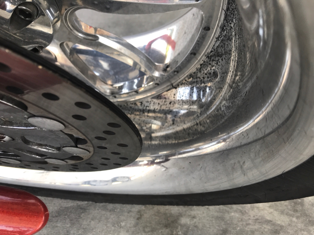

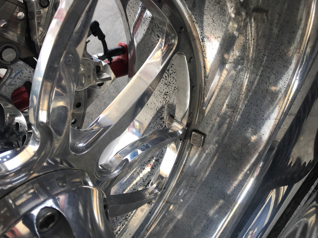

    Have been noticing over the past few rides that I’ve been getting rubber build up around the inside rim of the rear tire. It happened while it was just me on it, but more so with the gf on the back. Never had that problem before. I can’t see and didn’t feel and rubbing on the tire/fender while we were on it. Could it be just adjusting the shocks? Any other spots the rubber could be coming from?

    Mainly on the brake side.
    Could it be brake dust?

    That’s what I first thought. But it’s definitely rubber. I brushed the rim clean twice yesterday while riding (250 miles).

    Tail light rubbing.....ck ur tire for a pattern.

    Any unusual tire wear?
    Can you see anything rubbing up under the fender?

    Possibly fender/ strut bolts loose ?

    … like others said check belt alignment and tension;
    also do you ever roll the bike backwards? and with 2 up backwards, even 3 feet? this can cause the belt to rub against the side of the tire. (and belt could be going bad?)

    any sideways movement or wiggle from worn or loose rear wheel bearings, swing arm pivot bushings...
    best if checked with bike on a lift, gently but very firmly wiggle/pry rear wheel side to side and up and down, spin the wheel forward and backward to notice if belt starts to rub on things...

    First take compressed air and blow out your rear caliper and wipe off the rear wheel. Then go ride around for 15-20 minutes and only use your front brakes. Then inspect.
    With respect, I suggest the only stuff that would wind up on that side of the rim concentrating towards the middle would be brake dust.
    If this is wrong, at least you can rule out brake dust.

    Look at every tooth on the belt. Look at the sides of the belt. Centrifugal force flings out so it couldn't be a tire rub under the fender say. But the belt being inside the rim... buaddaboom buddabing

    Agreed but the problem is, it mainly on the brake side.

    Blinker/strut bolt back out?

    Wasn't there a recall back in the day on strut bolts -- a snapped strut bolt will chew the tire up in a hurry, especially riding 2 up -- trust me I learned that the hard way.

    Cheers for the replies so far. Its definitely not brake dust. They are clean as a whistle. Id sprayed them with brake clean before the ride and they were still clean after. Its definitely rubber. Hopefully get it up on the lift/jack and have a more thorougher look under the fender. The blet appears to be in good condition, it has the same slight clearance from the wheel its always had (the edge of the tire rubber is still sharp on the belt side). It did it a, little with just myself, but more with a pillion on the back, which leads me to believe its tire/fender contact. This has only started recently, which also leads me to think its something wearing out or failing. Hopefully its simple.
    So could that lead me onto the possibility of the shocks starting to fail?
    Does the tention on the belt change much with two up vs one? Ie the angle and distance between the two sprockets with no load vs two up? As it seems ive also developed a trans oil leak on the drive side, I think at the shaft seal.....Belt tension?
