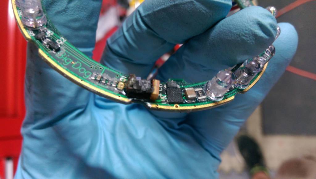

    So I tried my spedo and annunciator on a friends 06 and same problem. Spedo and annunciator are both fried. Took it apart and it appears that the sensor in the annunciator is burned. Will try to post some photos later.

    I've seen a fried tach board before and yes it will absolutely stop the RIP from working. But if unplugged the bike should still turn on.
    I bet the board looks like this?

    That is just what it looks like. Thank you. Any idea what caused it? I did unplug it and it still would not start. Thanks for the info.
