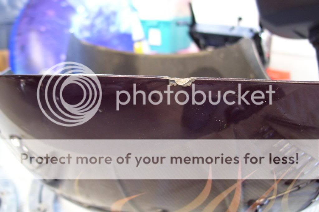

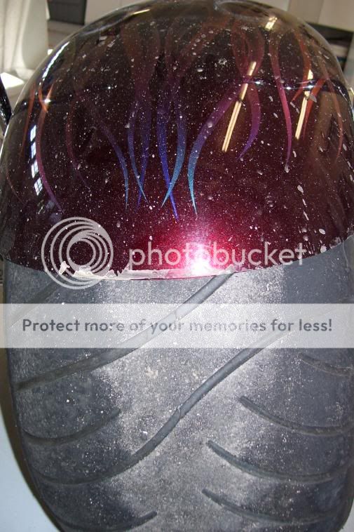

removed rear fender today to ship it back to BDM for a repaint due to ding from a spike in the tire. Found some interestring stuff along the way.

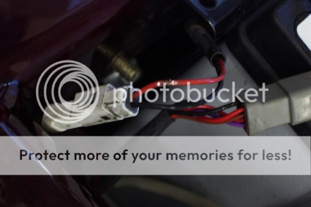

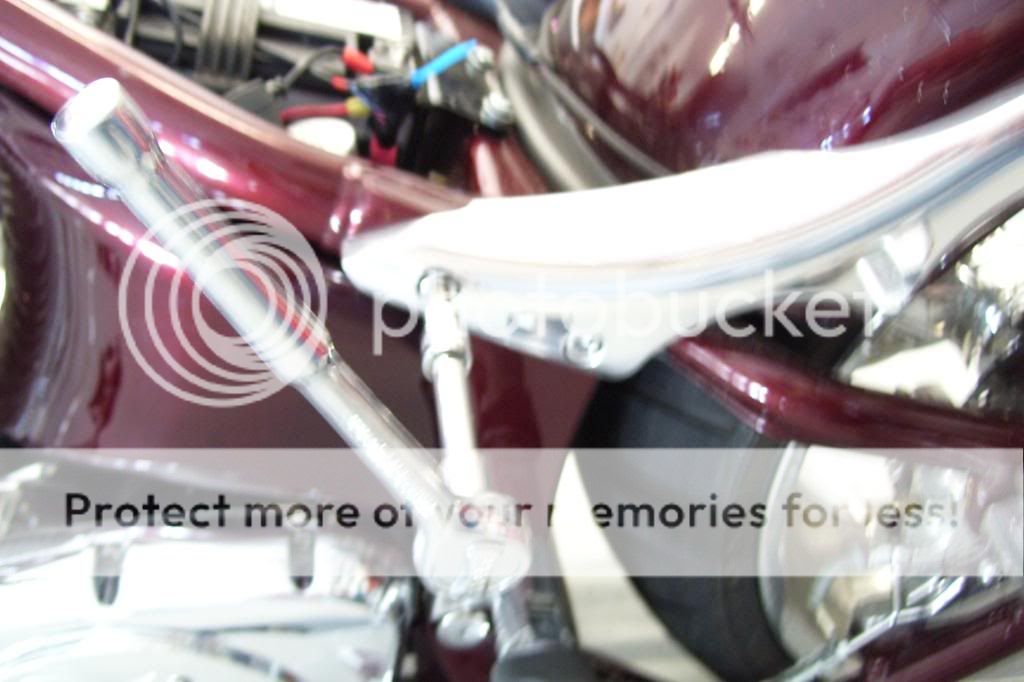

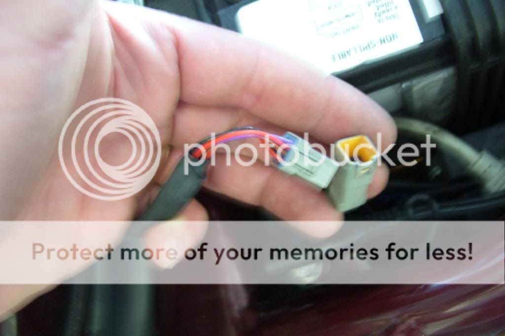

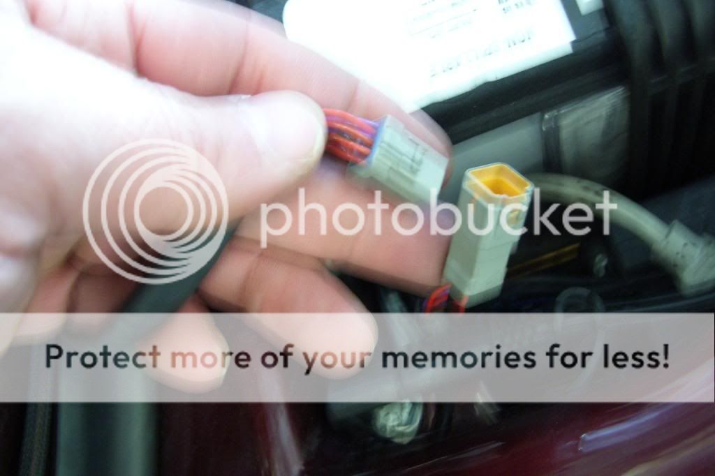

disconnected rear tail light connection
Remove strut bolts
My little helper
Removed one bolt on each side, this lets you drop the fender on the tire.

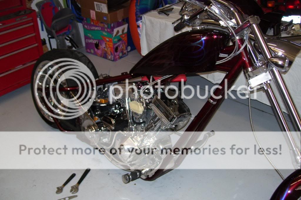

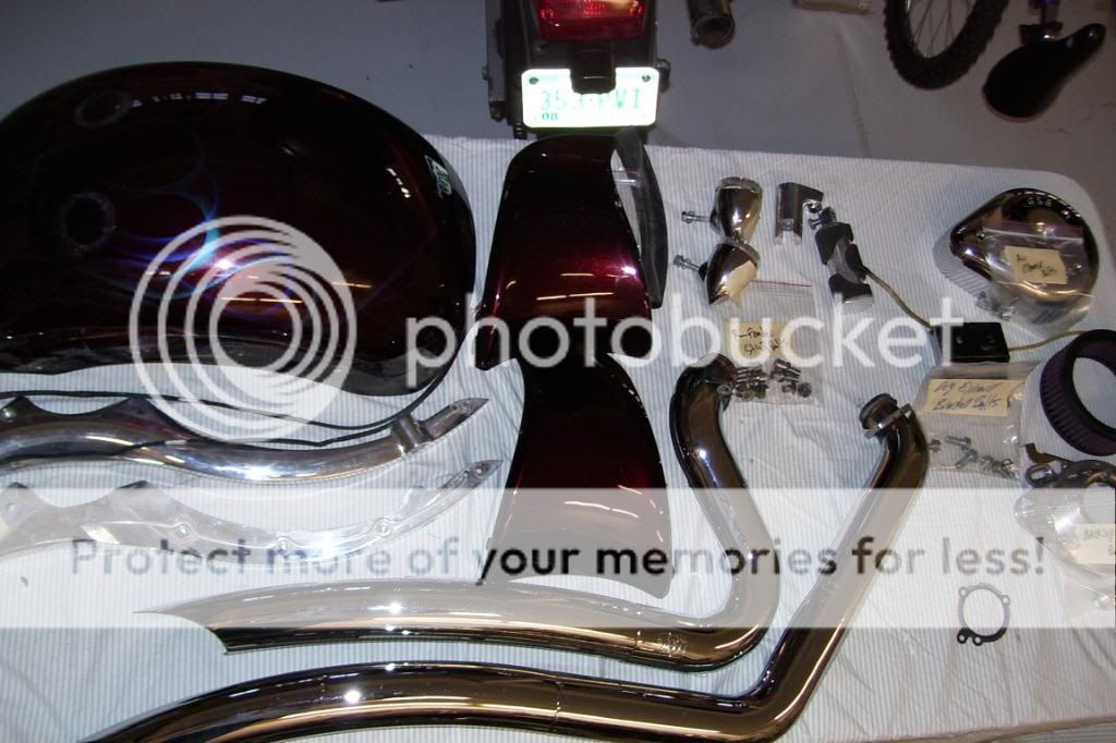

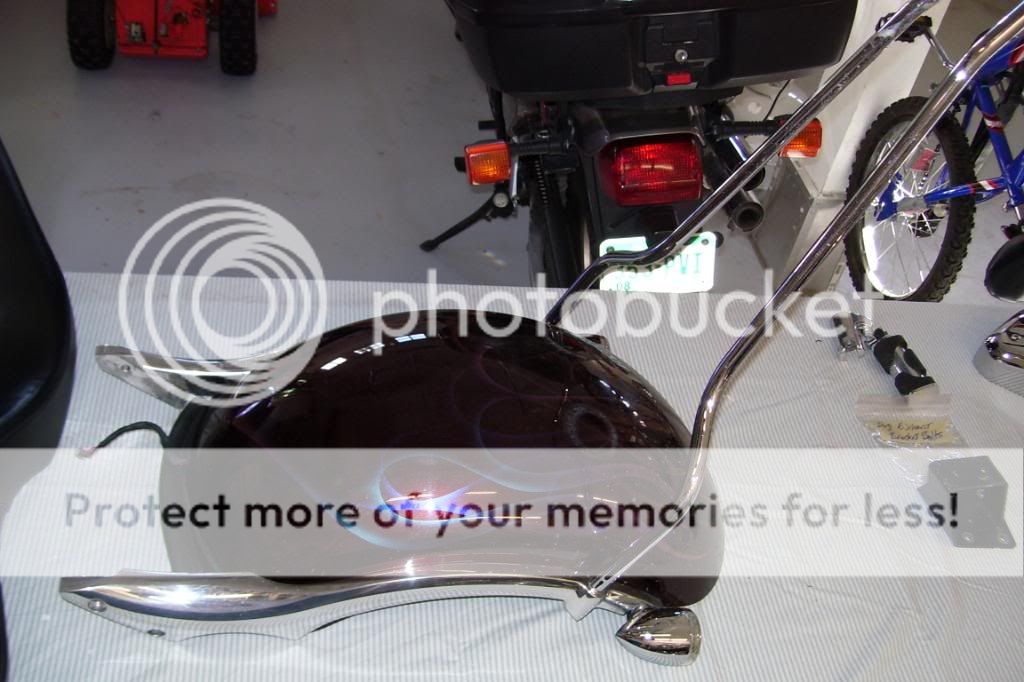

Fender, struts and sissy bar removed

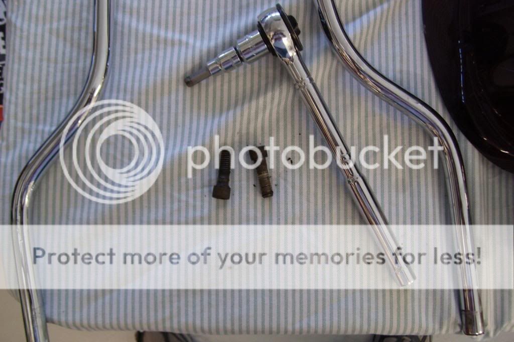

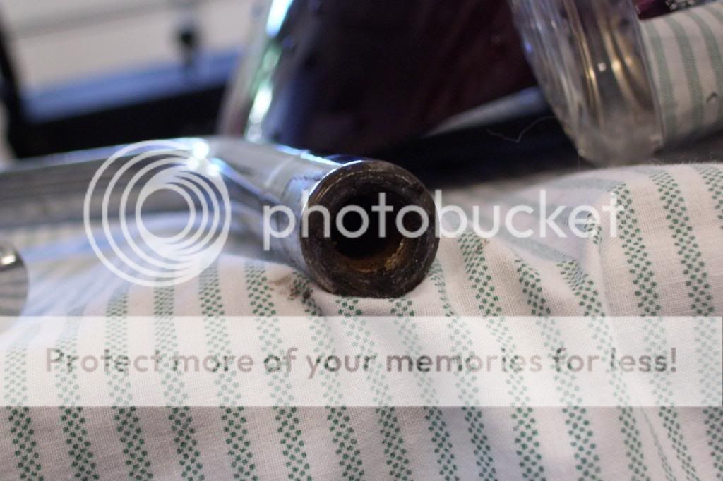

Removed sissy bar and found rusted bolts and bolt holes

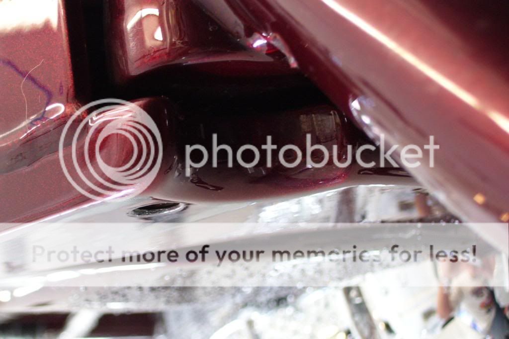

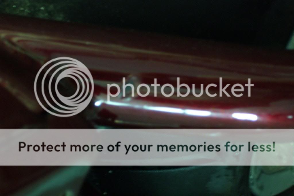

Found I had hit the rear swing arm on the frame stops. Don't know how this happened?? You would think BDM would put rubber stops on them?

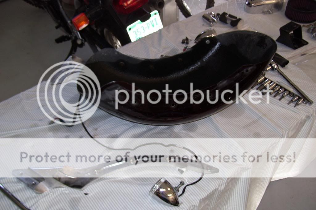

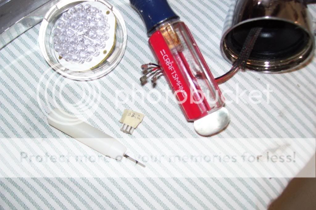

Disassembled the fender struts and tail lights from the fender

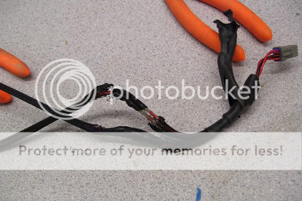

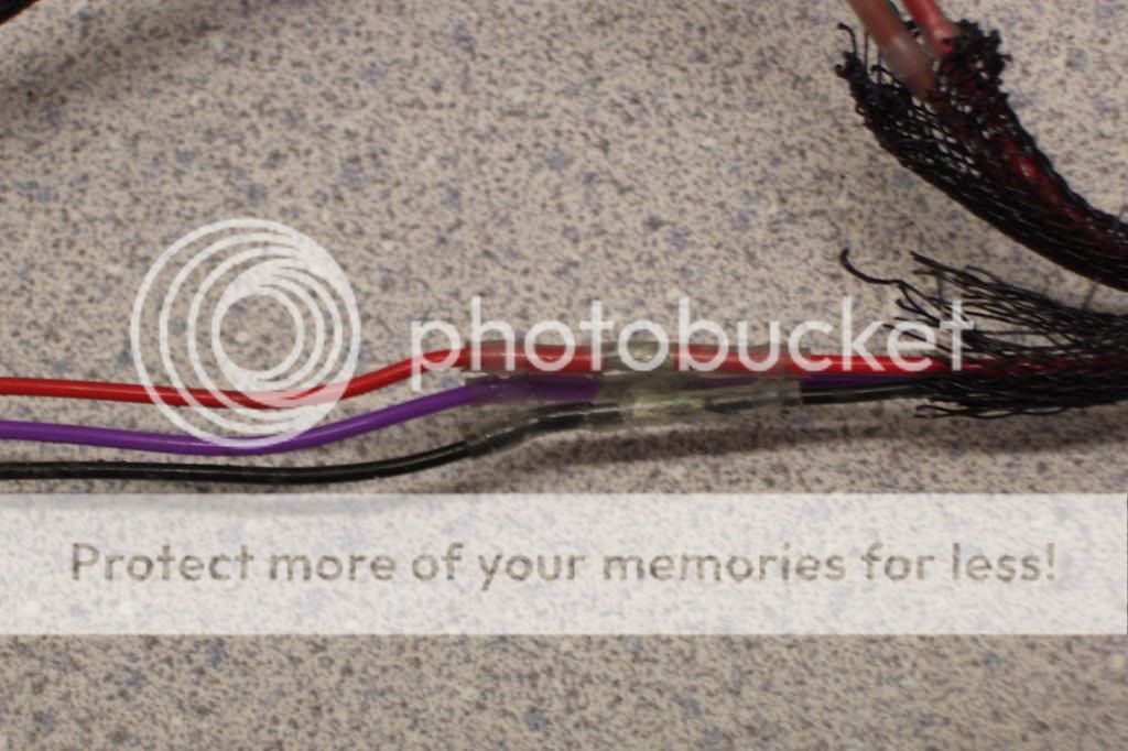

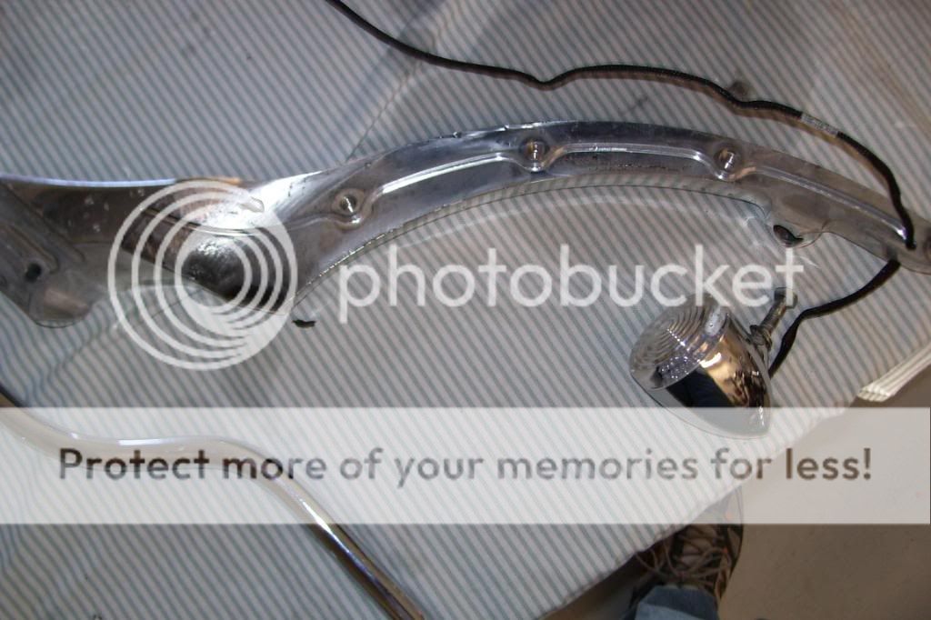

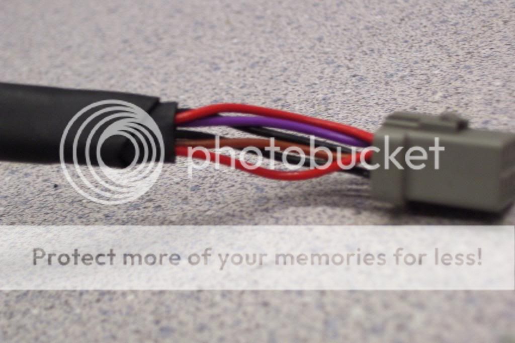

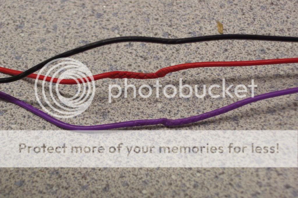

saw two layers of shrink tubing on the ends of the tail light wire harness. Did some inspection and found what I already thought was the case. When I had the dealer install the new fender struts fro the sissy bar rather then taking the time to unhook the wires from the connections, they just cut and spliced the wires.
In addition to the wire splicing, they crushed the wires between the fender and the strut on reassembly

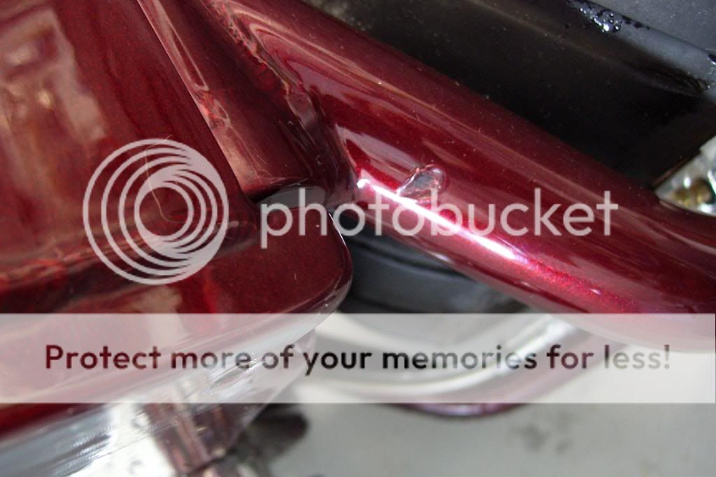

Finally the reason for removing the fender

Good job Rick, now get a big tube of die-electric grease and some shrink wrap and weather proof all that wiring when you put it back together.
To bad the dealer didn't do it the right way but at least you found some future problems or grounds.

Or at least, a better wrench than the dealer who screwed up your wires!!:D

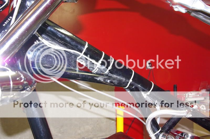

Rick, while you have the fender and side covers off you may as well take the tank off and do up all the wiring. With all the miles you like to do you water proof it like this.
From this;
[/IMG]
To this;
And my little helper. Ha ha
Rick
Ray I am all over it! I printed out the how to Gas posted on doing the wires. That is on my list before I reassemble. I also found other wires rubbed through see below.
I plan on inspecting the entire harness and making adjustments where needed. I really wish they had lef the traditional 12V system on these bikes like I had on my '03 chopper.
I found a few wires like that on mine. You will be doing some serious long term maintenance and prevention so good on you! :cheers:

Another steeler shows thier true colors .. Also get some conformal spray coating as GAS sugggests in one of his how-to's to seal the electronics in the lights.

Further, on the marks on the swing arms. that is the same thing I have on my dog. It's from the swingarm compressing all the way up and hitting the bottom of your fender struts. Its not hard enough to F up metal but enough to F up the powdercoating. Remove your fender stops and put at least big fender washers between them and the frame. It needs an additional 1/2" I'd say. I mentioned this in somebody's air ride thread... I told you guys I wasn't smokin the grass!

I've gone thru my wiring several times and I always seem to find something that makes it better. I use solder joints where I can and then terminals and environmentally sealed splices everywhere else.
