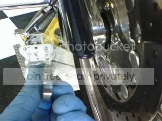

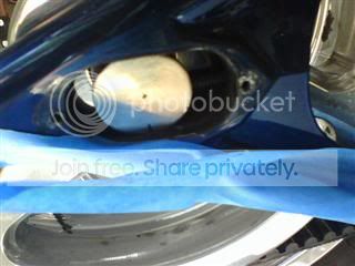

    making it easier. While you don't see much blue painters tape in my photos I would highly recommend taping the crap
    out of everything. Tools are all the time gettin away and when they do "Dents and scratches will occur" if you don't use
    "Painters Tape". Use painters tape because the adhesive is lighter and does not leave a residue behind especially if you
    can't complete the task same day and you have to leave it on for a few days.

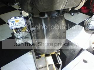

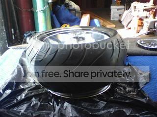

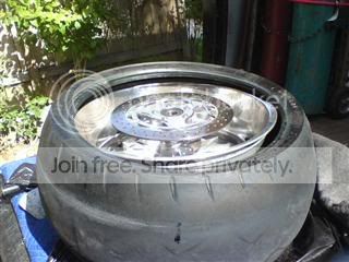

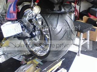

    When your tire looks like this its time for a new one

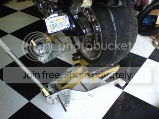

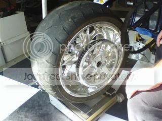

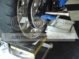

    So support the bike and the rear tire appropriately

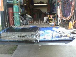

    Of course you will need a reasonable work area to change the tire

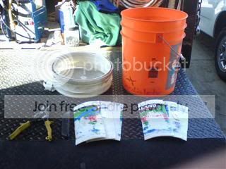

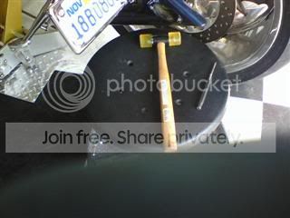

    Now you can spend your money on the edge guards but I think a five gallon bucket produces much better guards

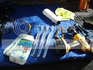

    Basic tools needed, and you will need (3) tire irons

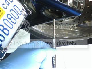

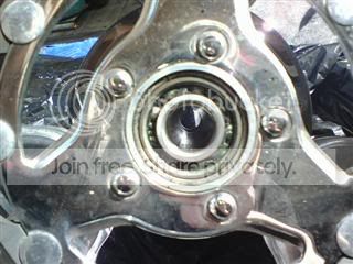

    A long stem straight punch makes it a little easier to get the axle out
    [​IMG][​IMG]
    [​IMG][​IMG]

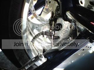

    Be careful about your spacers, pay attention to which one goes where and now is a good time to give them a good polishing
    Dont' forget to remove your caliper

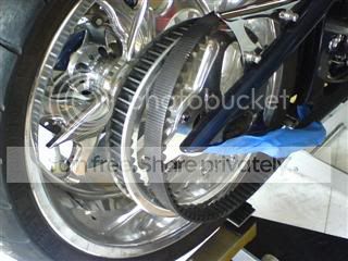

    Now gently slide your tire forward and down and slide the belt off and pull your tire out

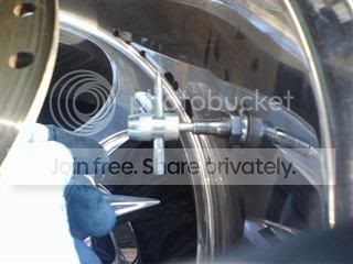

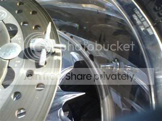

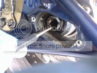

    Now, using an air valve core remover, remove the valve core. Be careful if your not careful the core will shoot out on you
    and you might not be able to find it. Not a problem if you have spare cores buttt.....
    [​IMG][​IMG]

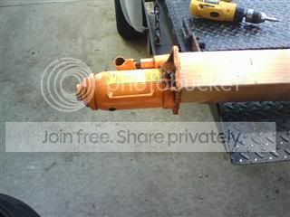

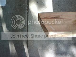

    The first thing you want to do is get yourself a 4 x 4 wood post and three screws. Preferably drywall screws.
    Cut one end of the 4 x 4 at a 22-1/2 degree angle, it doesn't have to be exact but I found it works very well at that angle
    Insert the screws about a 1/2" in on one side. Screw them straight in do not angle them
    Now take your small bottle jack, the smaller the better, drill a couple holes in the base and screw it to the
    opposite end of the 4x that you put the screws into. Pay attention to the direction you face the pump of the
    jack in relation to the angled end of the 4 x as you want the pump facing you so you can easily reach the lever

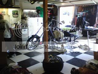

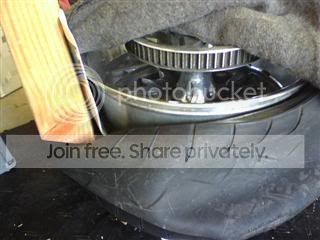

    Now lets setup the bead breaking base, line it up under a rafter in your garage or other solid surface you have access to.
    It could even be the bumper of your lifted four X just cut everything to fit
    Put 4 short 2 x 6 wood blocks on the floor to support the rim and to keep you from mdamaging your pulley or for you narrow
    tire guys your brake disk rotor and cover with a blanket
    [​IMG][​IMG]

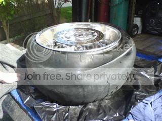

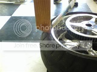

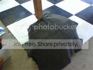

    Now insert the post against the tire as shown below, use one of the slick protectors you made earlier as shown,
    and lay a blanket over the wheel
    [​IMG][​IMG]
    Now I am tall so it is easy for me to reach the bottle jack you may need a short ladder. So begin pumping
    up the jack and Wah Lah the beed is broken. Now flip the tire and repeat.
    [​IMG][​IMG]

    Put the tire up on your work place

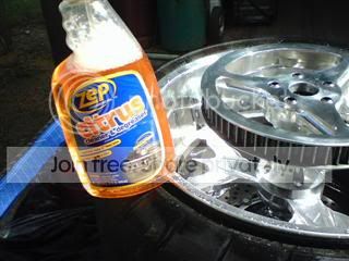

    Now I am sure there will be others here who have different ideas about the solution you use
    to spray down the tire in order to ease getting it off and on but I can only give you my personal

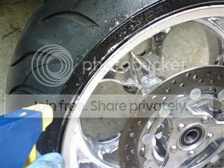

    experience. I use a citrus based cleaner solution water down a bit. I like this stuff the best because
    it is slicker than any other stuff I have used, including WD40, when the solution drys it is sticky so it
    adds a bit of extra grab at the tire edge to help prevent minute air leaks that occur occasionally with
    these rims, especially if you don't prep the rim's bead properly and as an additional bonus it does a
    great job of cleaning the rim whene you rinse it all off after the install.

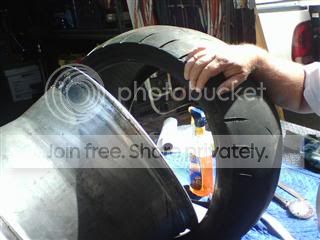

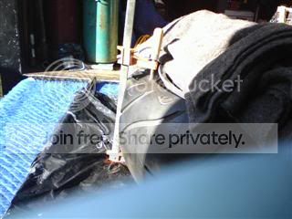

    Okay so you have sprayed the tire edge and inner rim lip really well with your citrus solution.
    Take your first tire protector and stick it between the tire and rim and insert your tire iron so the
    bent tip hooks the edge of the tire. If you will note I am using the curved end of the iron with the
    bent tip facing the tire. Now pull the iron out towards you. Watch the protectors and keep them in place.
    This portion of the process is way easier with a helper

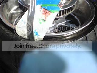

    We want to spend a little time now prepping the inner bead so you get a nice tight seal when you install the new tire.
    Using a wire wheel on your cordless go all the way around the inside of the rim at the bead and the edge of the wheel
    and give it a good thorough cleaning. If you have any nicks or gouges in the aluminum at the inner edge of the outer
    portion of the wheel then now is a great time to file and sand those out so they don't cause any micro air leaks.

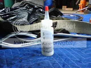

    Now is a good time to install your Dyna Beads but you must be careful through the rest of the tire install to
    avoid pouring them out. You will note I marked my bottle to make it easier to establish the amount I am putting in.

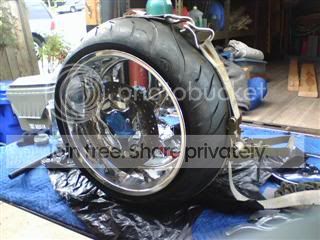

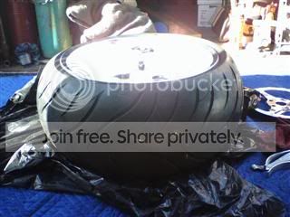

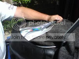

    Easiest way to seal the tire so it doesn't leak while setting the bead. Take a ratchet tie strap,
    wrap it around the middle of the tire and hook it end to end. Now tighten it down just enough
    to prevent air from leaking while you seat the bead.
    Install your valve core and inflate the tire to approxiamtely 60 PSI. It may take a little more for
    your tire but when you hear a couple of loud pops and both sides of the tire are completely flush
    with the rim you ar there. Reduce the tire pressure to 42PSI or whatever your tire requires.
