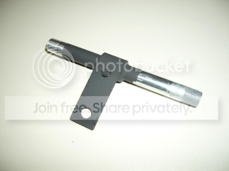

    What it takes is a flat gate reinforcer (~3 inches), and 1/8 NPT gas line (~ 4 inches) and a cap. Here's the basic idea;

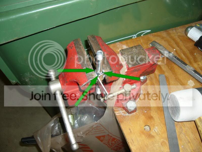

    Bending the reinforcer around the gas line gives a good surface to weld against (green arrows);

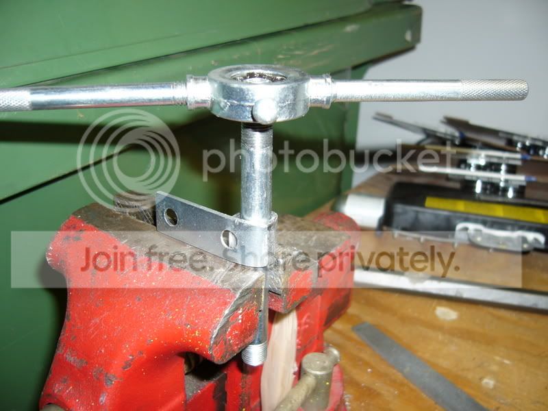

    I didn't want to count on the welds when I changed the oil, so I tapped out the thread longer and tapped out a nut to act as a locknut;
    The locknut is on with red locktite. It will be held to rotate off the drain plug.

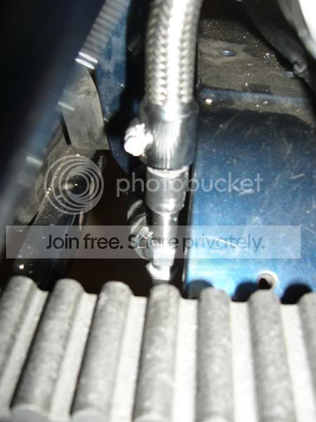

    It sits close to the rear shock bolt so it will have to come off when working on the shocks. So far it's been on for four months, no problems.
    What it looks like mounted up;
