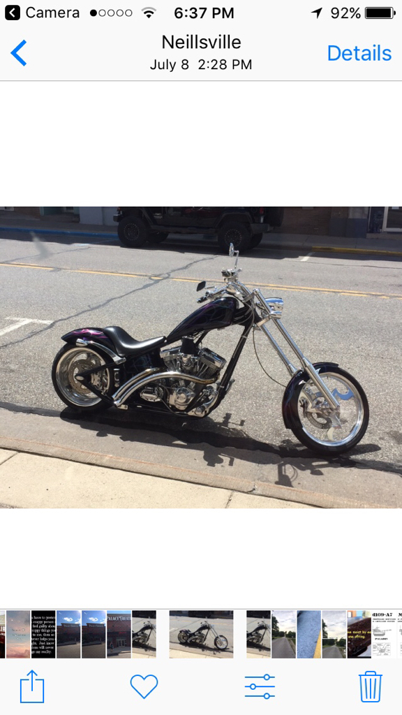

    Was heading up to the cities (mpls/St Paul mn) last weekend to have some ele work done on 04 Chopper. Must have dropped a bold out of the shocks about 100 miles before I got there.
    Anyone know what a set of shocks cost????

  13. jor43387
    jor43387 Member
    Jul 27, 2017
    40
    28
    18
    Wisconsin
    These fit on the O4 Choppers?
    And where do I order these.
    Just had one break off!
