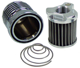

  12. KnotSo
    KnotSo Admin
    Apr 16, 2007
    11,543
    1,656
    Washington
    Do you want to purchase and install new filters every time or do you want to reuse a cleanable filter each time?
    Just another option:
    OIL FILTER CLEANABLE CHROME SPIN ON FOR ALL BIG DOGS
    Kit includes canister housing, mount plate, seals and cleanable element.
    Filter down to particles as small as 2.56 microns and has an intergral magnet placed in the element. Replacement stainless steel or paper elements are available separately.
    Home BIG DOG MOTORCYCLE PARTS BIG DOG PARTS 05 and newer Engine Oil Filters OIL FILTER CLEANABLE CHROME SPIN ON FOR ALL BIG DOGS
    http://www.wildsteedworx.com/index.php?main_page=product_info&cPath=68_173_77_149&products_id=1093
    Been using one like this since 2006 on my Mastiff.
    :chopper::chopper:
