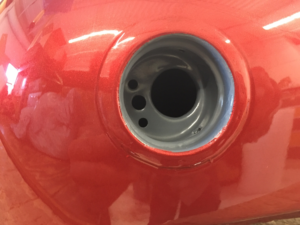

    Here's my tanks off my 05 Mastiff after Fuel Tank Services in Ft. Lauderdale did them. Mine was expensive because I have to tanks so it was 1k for lining both tanks, and it is lifetime guaranteed. It should be around a 30 day turn time. I tried cleaning mine out with screws, didn't work. Now, it did take me 8 months to get my tanks back because I opted to have a scratch and several chips repaired even though I was told it would only be another 30 days. I did go round and round for months with George about this. Anyway, your tank should be around $500 and you should have it back in 30 days. I have some Caswell Dragon seal you can have if you want. I'm never going to use it. My tanks were pretty rusted under all that coating that was peeling off everywhere also. Anyway, good luck with whatever you decide.
    FrankBDPS, bigkelk9 and chubs like this.

    JJ
    Wow. Looks great but Pricey$$$
