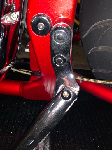

9797E877-50D8-41CB-935B-4065156E5F8B.jpeg89A1C5D7-2020-4626-8D6F-97DF785D8741.jpeg6FAEF885-4605-4622-A907-0D8F858A1C6B.jpeg

The more I look at the picture you posted it looks to me like your kickstand is about worn out.
It looks like it is hyper extending which is going to make your bike lean even farther and eventually slip past the stop and dump your bike onto the ground.
In other words when you flip your kickstand down it is getting worn out enough that it’s gonna go past the stop and fold up on you. If you look at the picture of the one I put on my bike it’s more in line with the bracket that holds it to the bike and if you look at yours it’s going past that point By a lot. So your bushing or bolt or bracket is Wollard out or the combination of all three.
That is the reason I originally replaced my kickstand it was doing the same thing . When I pulled it apart and looked at it the bushing and the bracket were worn out. From what I’ve seen on the form here it seems to be a common problem with the BDM kick stands design.
I only got the 1 inch longer one which turned out to be almost 2 inches longer because I didn’t like how the bike leaned and it was only A little more $$.
Sure hate to see your kickstand fail on you and dump your bike on the ground and from the looks of it in the picture you took it’s almost there.
Good luck on whichever route you go

Brent -- LHS is right, your kickstand is worn -- badly.
I know as I have over the years killed several. Either put a shim in there and secure it so that the kick stand lines up with the *slot/groove* in the mount or get a new one.

My kickstand is over extending too. I need to get a new one or fashion the shim for it. What I do is lightly push the kickstand back with my boot before it touches the ground. Then lean the bike over and let it gently roll backwards. The kickstand will lock into the grooves before overextending.
