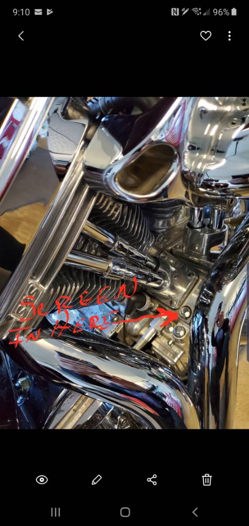

  15. BigDogBro1
    BigDogBro1 Made in the USA
    Mar 9, 2008
    2,047
    216
    63
    Near Hell MI
    07 Bulldog, full chrome, Pergy w/gold leaf paint, V&H BR pipes, Gator & Ostrich seats
    Don't forget to check and clean the tappet oil screen at oil change time.
  16. phatchopper300
    phatchopper300 I just wanta ride
    Full Member
    Aug 4, 2009
    2,333
    329
    83
    Morganton, (Western) NC
    08 k-9 Dakota spedo, RIP Kit gen. one 585 cam 2 1/2 forward contr
    Mike
    Thanks bigdogbro1 will check.......very frustrated now couldn't get program to read my cable and was very difficult for the serial port to be inserted into the ECU frame was in the way Had to move a lot around to insert serial port. I will check tapped screen tomorrow. The red engine light comes on about 15 sec after turning key with out turning over engine. Same when turn engine over..... Just got bike about month ago no issues had many long rides and then Sunday 15 min into ride engine light came on?........????.?.?.
