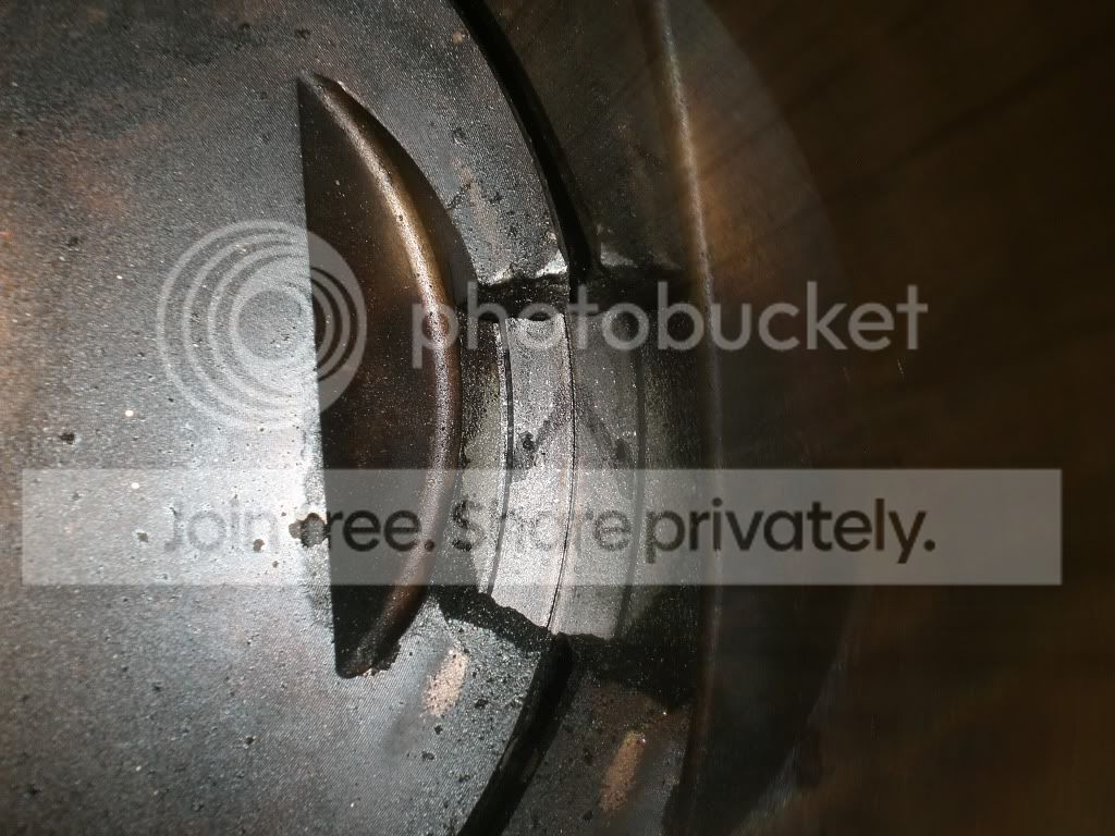

    Tear Down
    Remove Exhaust & Ignition Coil Assy
    Remove Carb
    Remove 6 Bolts on Valve Cover
    Remove 5 Bolts on Vavle
    4 bolts off Valve Housing
    Remove Push Rods (Mark FRONT AND REAR)
    Disconnect Compression Release under Seat
    Cut Wire and Remove Ground wires
    Use safety wire to pull through frame (LATER)
    Lay to the side
    Remover 4 1/2 inch 12 point head bolts
    Watch out for Guide pins while removing Heads
    Using rubber Mallet remove Cylinder (DO NOT FORCE) Hit at 90 Degree
    SUPRISE Found Broken Top Piston Ring (On Rear Cylinder)
    Forward Piston Found 1" Piece GONE!!!!!!
    Both second Piston rings Frozen
    No Damage to Cylinder Heads or Valves
    Rotate engine (Put bike in gear turn rear tire)
    Put rags in all Holes
    Remove sir clips on Both Sides
    Pull Piston Pins
    Pistons are Marked on Bottom
    Keep Shit Seperated (Front rear and OTHER)
    NAKED DOG
    Bad PISTON Ring
    BAD FORWARD PISTON

    I repeat what I said before - I feel for you. Any idea what caused this to happen?
  8. hoat
    hoat Well-Known Member
    Sep 21, 2007
    1,700
    25
    38
    Great write up. Do you think that you got stuff in the bottome end?. I think there is a plug in the bottom of the cases. I wonder if its worth douching that sucker out?
    Just a thought maybe someone else can weight in
  9. Vegas
    Vegas Well-Known Member
    Nov 7, 2007
    2,381
    19
    0
    Henderson,NV
    What a mess huh...looks like it may have been running lean. The piston in the hole is pretty clean.
  10. 05chop
    05chop Well-Known Member
    Jul 17, 2007
    1,152
    122
    63
    wyoming
    05 DT Chopper & 2010 Street Glide
    Can you turn the piston upside down and take a picture of the bottom side for us . Is the bottom side all discolored? Also can you see any cracks on the piston? From this picture it sure looks like de-bonding or faultily piston material too soon to tell though. [​IMG]

    The problem is I ride at 4000 then up at 10,000 above sea level then at sea level out in San Diego. Wish I could change it on the fly
    I think tonight I will dig deeper means I am waiting on Parts. I have to order them today just want to make sure I get the right pistons on order today. They are comming from Wisconson and I will order them 2 day air so should be here Friday.

    The bottom side is CLEAN Wierd Huh
    Sides Clean too

    WHY OH WHY

    See if you can make a complete circle out of the broken ring! Im not sure on this motor but im assuming it has piston oilers correct? That ring broke after the piston broke loose my guess. You can barely see small cracks on the piston crown I was looking for a picture of the bottom side of the exposing the broken piece for excessive heat.

    Were the rings broken in exactly the same spot?

    No it wasnt
    Back ring was in 20 pieces this is it

    What the hell is that somewhat white looking sh*t above the oil ring,in the groove? (edit) now I see, it's on the bottom side of the scraper ring. But what is it? I've built a lot of race motors, and never seen anything like that white sh*t. I've seen the way the rings are broken before. It's from ring expansion!

    Dead1 bad picture not white

    Are you going to check the valve seats while you got it down? Small material off of the piston can mark the exhaust seats looks like you have good shop tools.
