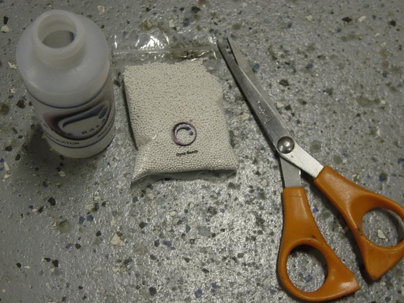

    Grab your supplies

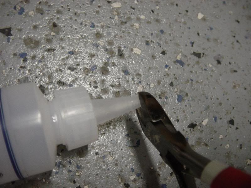

    Cut the top off the applicator for easier pouring

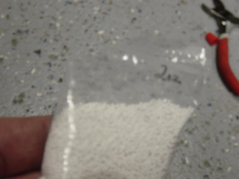

    Grab your bag of beads
    Cut open the corner of the baggy to dispense into applicator bottle.
    Pour into the bottle

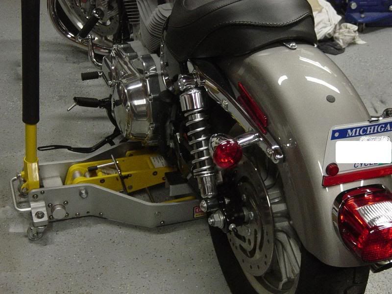

    So I jacked up the sporty like so...

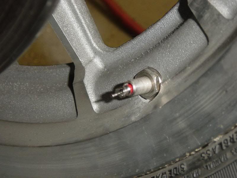

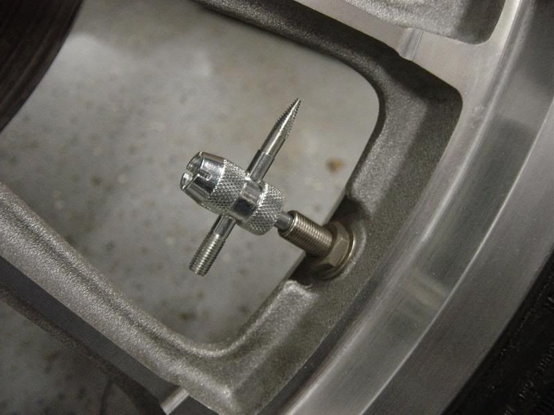

    Remove your valve stem cap

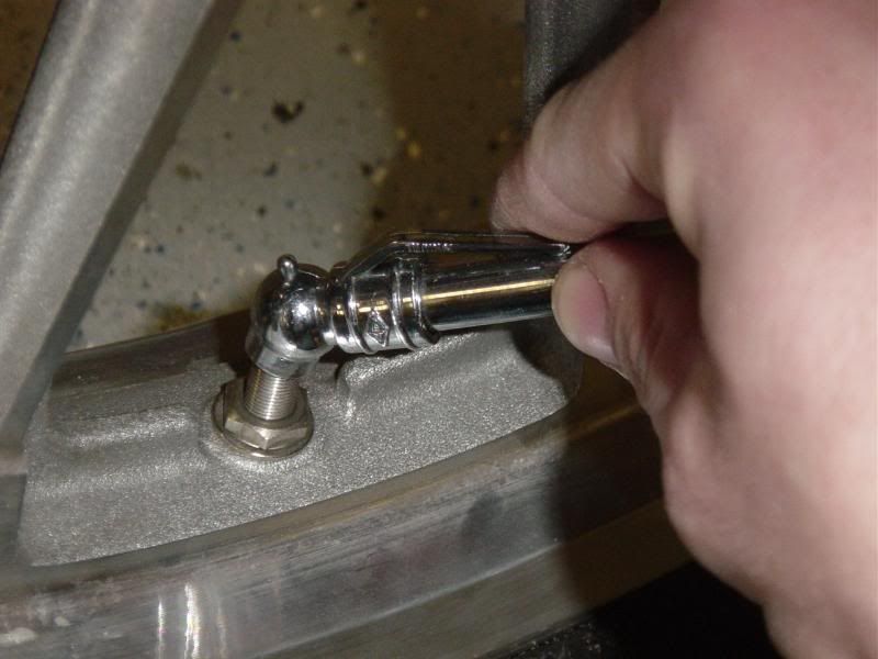

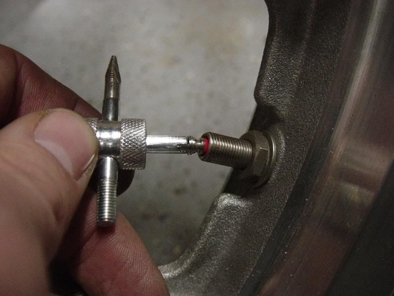

    Get your valve stem tool
    Spin out the valve stem slowly allowing the air to leak. At this point you can either let it all leak out or pull it out carefully. Be sure not to go to fast and put your hand over it, while keeping pressure down on the tool and stem. You are trying to keep the valve from flying accross the garage.

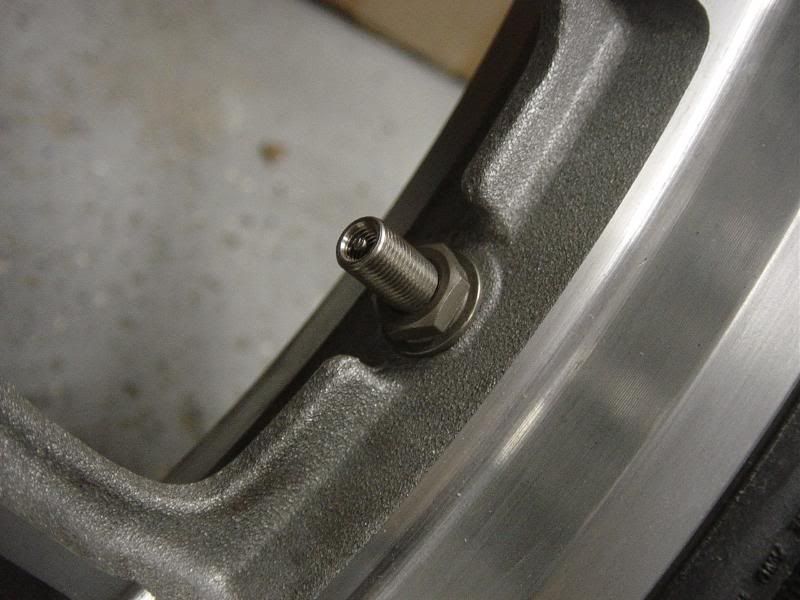

    Out comes the valve
    Set this aside

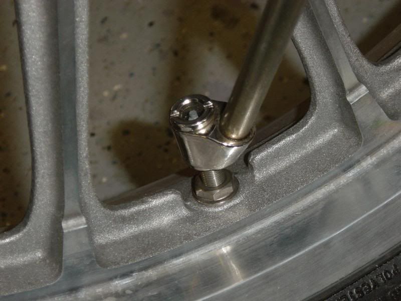

    Hook up the tube to the valve stem
    Start to pour in the beads slowly. If they start to back up and won't flow into the rim like this read the next direction. If not skip over the next part for difficult bikes.

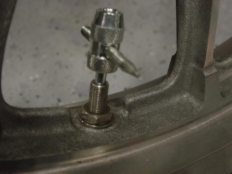

    Loosen the valve stem nut holding it to the rim.
    Attach the tube
    Fill the tube and it will back up like before. But push the valve stem in and out shaking in the beads. You can fill the entire tube and then shake in. This worked great for both front and rear tires. ​

    Milk...good call on getting the wheels off the ground which I did do as shown in my pics of the bike on the sears jack.
