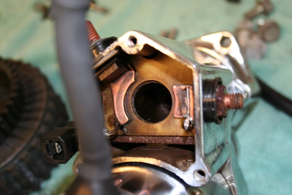

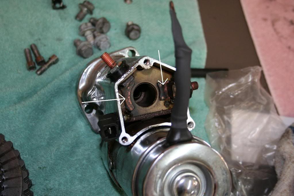

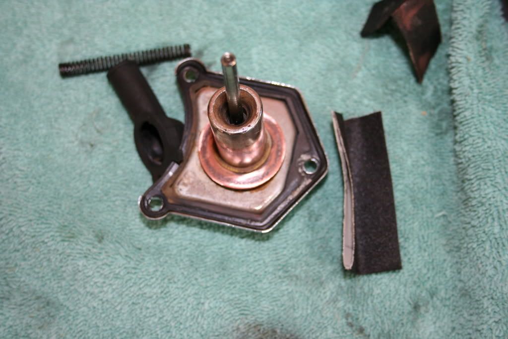

    If you get that starter click, click, click then it catches this may be your problem.
    Dirty contacts in the solenoid. Pull the end cover off and remove the plunger then just take some emery cloth (150 grit) and clean them up.
    This lasted over 5k miles untill the oil seal failed!!
    Before:
    After, still needs some work but you get the idea:

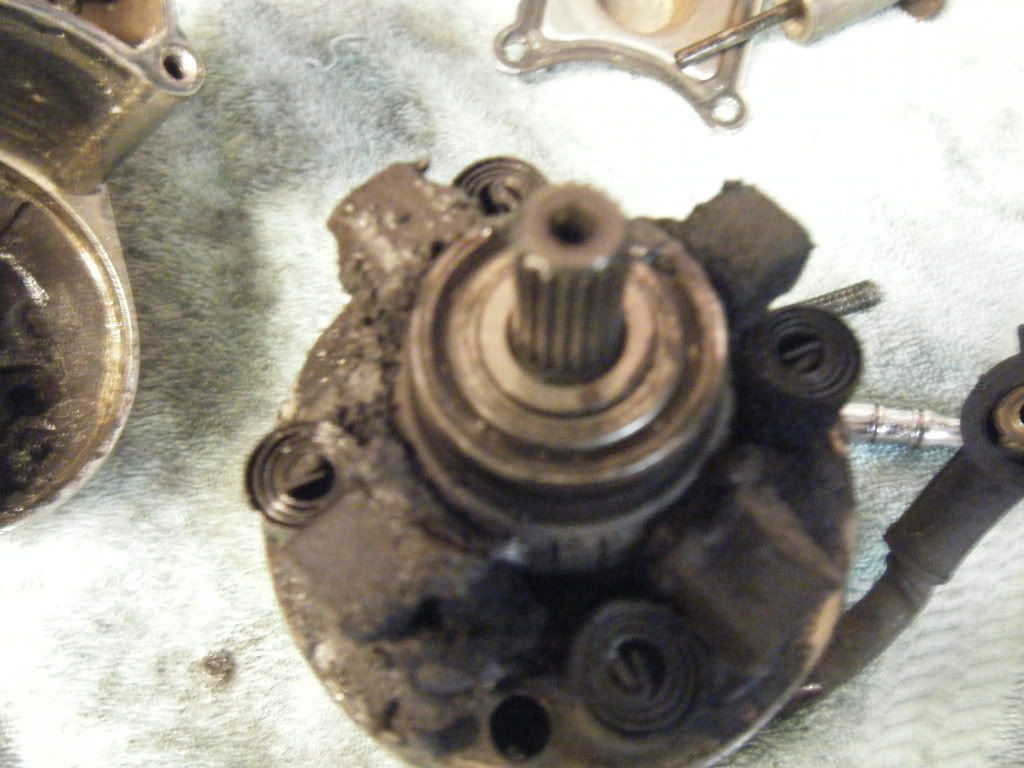

    No click click this time

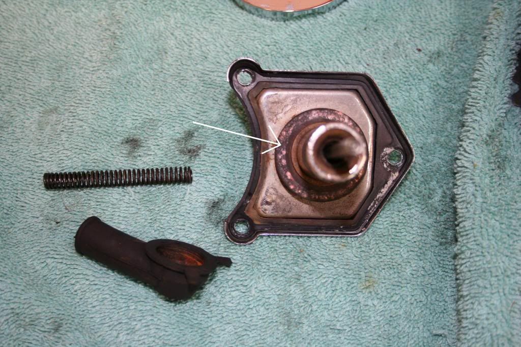

    Well this time it got oil in it and its about done this time, probably clean it up find some bearing and seal to save it for a spare.:down:
    Dont like it when it looks like this!!!!!

    I was going to say something after seeing this thread the other day. Looked like it was starting to leak then. I bet you were marking your territory lately.:bang:

    Lasted 5000 miles!!!:2thumbs: Just started in the last few hundred miles no notice of dripping yet.

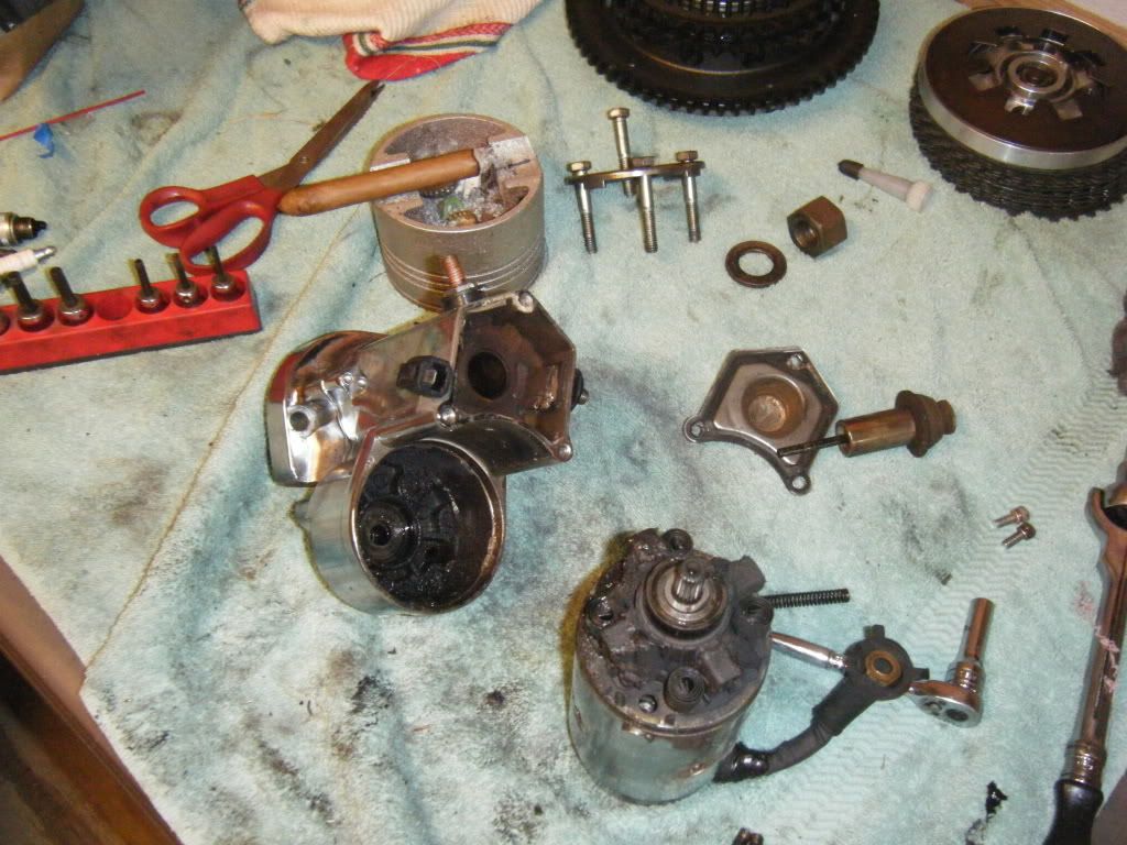

    This is for Gas "By The Book"
