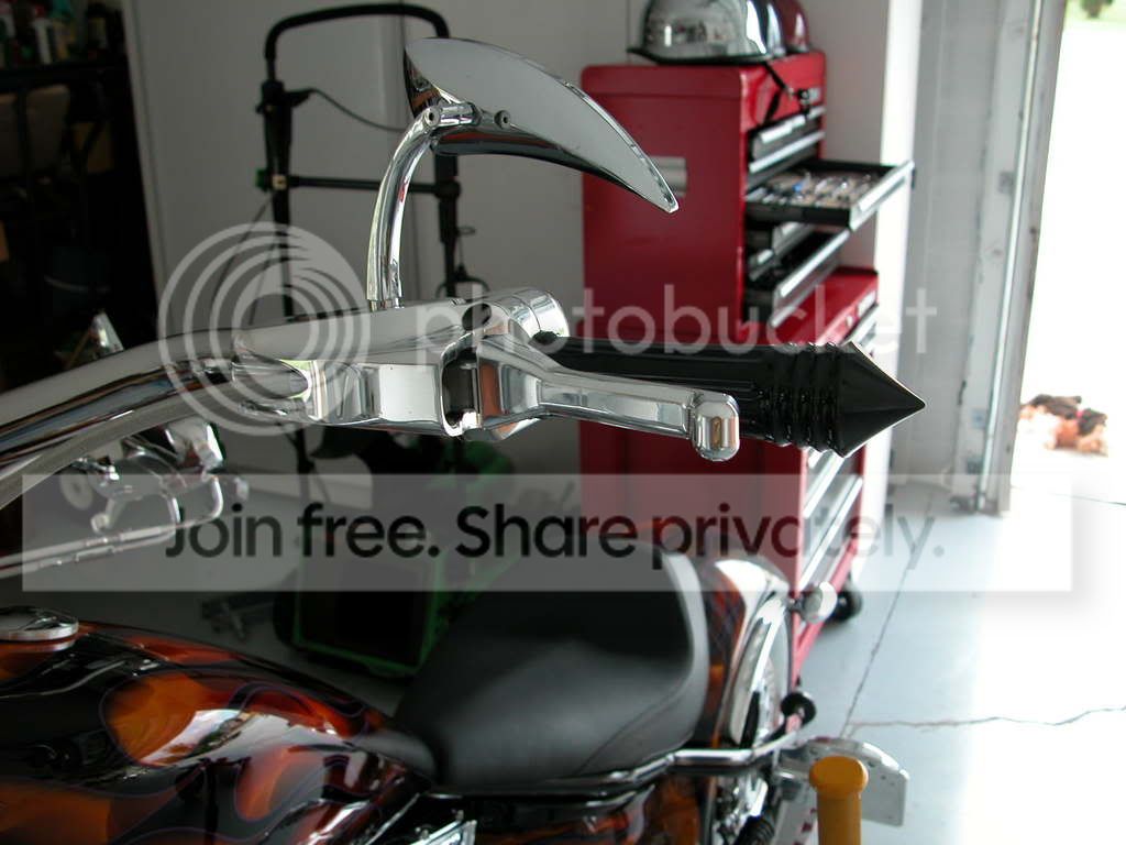

    My shifting was hard and finding neutral was difficult. After adjusting my clutch, my shifting is now smooth and finding neutral is a breeze. This is how I did it. After leveling the bike, slide the clutch cable boot to access the cable adjuster
    Loosen lock nut and turn adjuster clockwise to loosen cable and give full slack to your clutch lever. It should look like this.
    Now remove the clutch adjusting cover to access the adjusting hardware.
    Loosen jam nut with 11/16 wrench and turn pushrod clockwise with a 7/32 Allen wrench until stops (only with light force) now turn pushrod counterclockwise ¼ of a turn and tighten jam nut.Install cover.
    Finally adjust your cable to give your clutch lever 1/16 of free play. Tighten the jam nut and slide the boot back in place.
    Enjoy your smooth clutch. If this adjustment doesn’t do the trick for you, consult your near BD dealer.:)

    Lee, I took my exhaust off to see if I could do any mods to it. You don't have to remove your exhaust to do the clutch adjustment. If your allen wrench does not fit, cut it in half to work around the exhaust.

    you might want to mention that the clutch adjusting cover spins off and I had to use a oil filter wrench with a adj rubber band to get it off.

    Also another method to remove the clutch adjusting rod cover is to pick up one of those rubber tipped door stops at the hardware and saw or grind off the screw end flush that screws into the base board, then just place the rubber stopper end in one of the recess areas of the cover and tap lightly with a small hammer in a counter clockwise direction and it should come off easily, the rubber protects the chrome and won't do any damage. Don't forget antisieze when you reinstall it.
