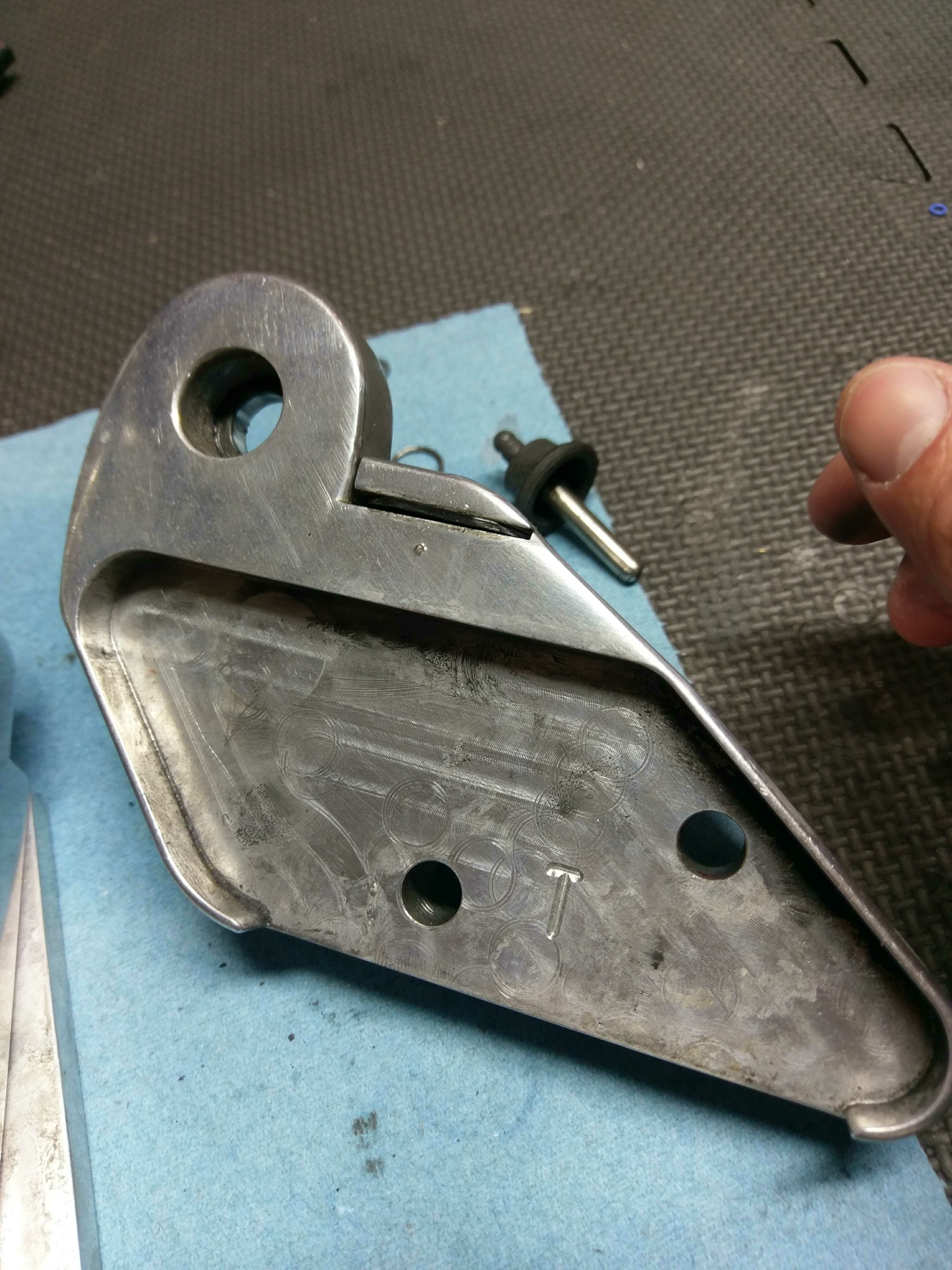

    I got my rebuild kit in and installed. Still a drip! I removed the cover and mine is cracked. This is gonna be pricey. Where can a guy pick up a new assembly?
    1st pic, you can see the crack.
    2nd pic, on my chopper there were 2 Allen head 5/16 holding the assembly to a mounting plate

    That's fixable maybe. You know anyone around your area that can weld aluminum? If not, send it to me and I'll take care of it.

    Yea, I know a guy that has a high frequency machine and is a pretty good welder, but man, this thing is cracked almost all the way around
