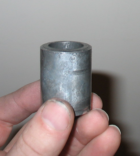

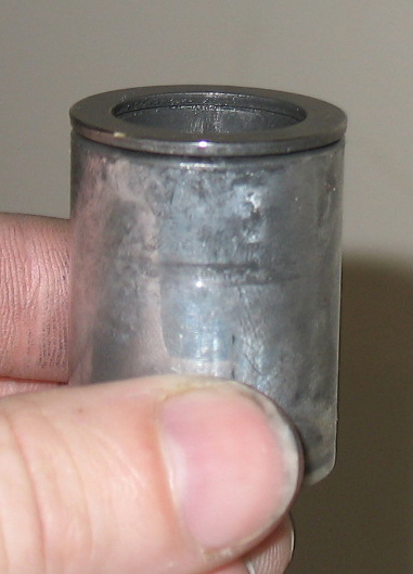

A month back I noticed my wheel was moving sideways causing my front brakes to feel funny. Actually that's how I figured out my front wheel was moving in the first place. Since the bike was still under warrantee then, I took it in to have it checked out. The tech just put a shim in and told me the set screw had worn the spacer which was causing the wheel to shift back and forth.
The wheel still moves back and forth, just not enough to effect the breaks. You can can even hear the wheel assembly shift when you turn the handle bars back in forth. I put the bike up on the jack yesterday to get the wheel off the ground, and I could move the wheel a good 1/16" (maybe less) or so laterally. You can also move the spacer on the right side back and forth towards the wheel.
I don't feel this situation effecting the ride or balance...yet. Anyone else run into this situation...especially the choppers and ridgebacks since we have the small front wheels and huge spacers.

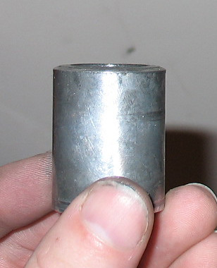

Yesterday I took out and cleaned the pinch bolts and used a tie-down strap to pull the fork legs together while tightning the bolts back up. I'm pretty sure that the spacers are not suppose to be turning with the wheel. I can hold w/ my hand and push the right spacer towards the left side and the wheel will turn nicely by itself, so this tells me I either need a new spacer or I need to go pick up some shims. Any Autoparts store should have shims right?
Chuck, I agree with Sul. There shouldn't be that much play in there. Did you have the front wheel serviced by the dealer? They may have put the wrong spacer back in.
I would definitely get the proper sized spacer to tighten everything up.
Good luck,
Ray:flag:

It hasn't been doing this from day 1. I believe it was a gradual thing or a different sized spacer could have been put it after a service and I just didn't catch it, because the movement is only noticable when still and turning the handerbars all the way to the right then left. It was really bad before they shimmed it...so bad that it was effecting the front brakes. The first thing they checked were the bearings and the tech told me they were fine. He said the the spacer wore down and that he just put a shim between the spacer and the right fork leg. I can see it and it's just not big enough..needs another 1/16" shim.

Wheel is back on now...I decided to see what would happen if I flipped the spacers. The axle was a bitch to get back on by myself but once I got it though, I snugged down the pinch bolts, snugged the axle bolt, torqued the pinch bolts to 18 ftlbs then torqued the axle bolt to 50 ftlbs. Spacers are snug now and everything is back to normal.
