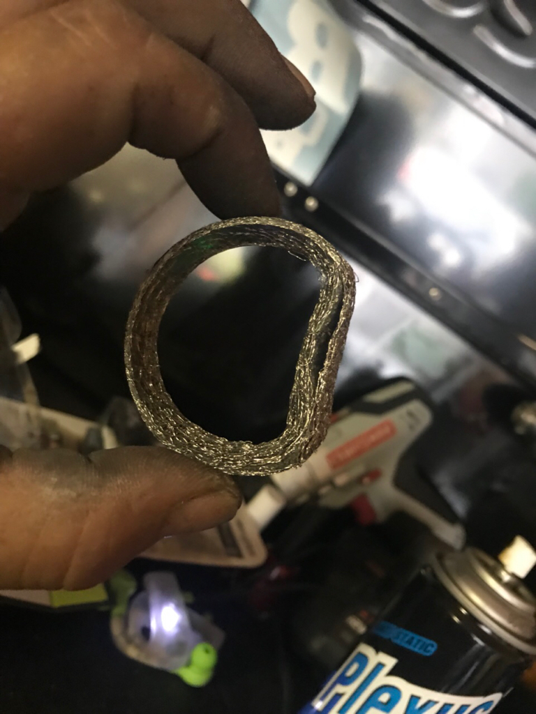

    Do I have to get another pair of new ones?[​IMG]
  9. BWG56
    BWG56 Guru
    Jul 29, 2008
    20,769
    36,497
    Big Dog, SpyderF3
    Ker
    Not really if you can get it in there and run a round bar of steel (Philips screw driver shaft) over it to get the tapper for the pipe.

  11. woodbutcher
    Aug 16, 2007
    10,748
    4,465
    hilton head is., sc
    black cherry '07 K9
    Tom
    looks like the same reason why i get 4 new gaskets when i'm replacing 2 of them. glad i'm not the only one that does that.
