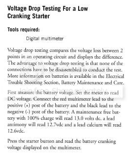

    Voltage Drop Test for Low Cranking Starter

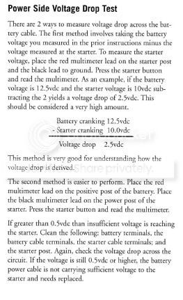

    Power Side Voltage Drop Test

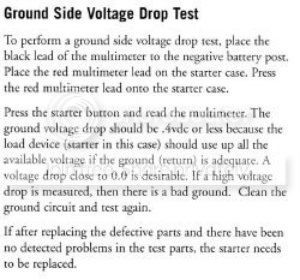

    Ground Side Voltage Test

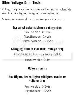

    Other Voltage Drop Test

    This an open question regarding my 05 Ridgeback. Currently the dog won't start when cold. Appears to be normal but engage the starter click only. (New battery, 12.6v, connections good) Come back when the day warms up, starts normal. Last couple of times on the road on a cool day engine cuts off, coast to a stop, restart ok or cranks only. Saw something about a starter relay?????? Today the clicking continues. Can anyone help?
