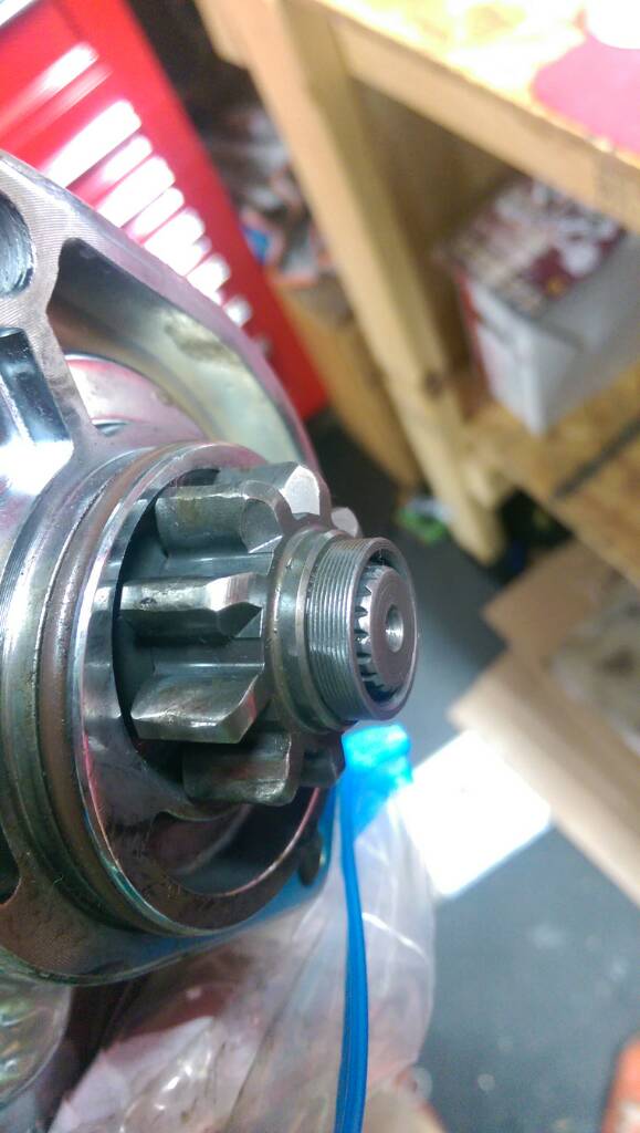

    Is the occasional bang heard from the starter caused by starter bendex wear and corrected by purchasing a starter or has anyone personally rebuilt one? Does this eventually knock a tooth off of the ring gear?

    I flipped my ring gear around when mine stared acting up. No problems since. Jmo.

    Agreed. I've broken two starter housings and they prob get twisted a bit when they start cracking.
    I think personally I had problems with PDM and the compression release wiring (not always fully compressing them, thinking low voltage) which was causing the kickback on the starter which cracked the housings. Last one had cracks in under 2K miles and 1700 was one trip so not many start cycles maybe 40-50

    I don't think he has that option on his 06' if its the same as my 07', the ring gear its part of the clutch basket

    Agreed there is no better chance of you aligning it correctly do first than neutral than when you turn it off.
    When you put it in gear and move the bike you ain't moving the starter ring and when you slip it back in neutral it's in the same spot. You might move it 1/16" an inch at most since there is a hair of play. Remember you would have to move the primary chain and pistons to actually move your starter ring in gear since its all one unit.
    The starter gear is angled and notched to slip into the ring gear regardless of positioning. Where it gets hung up is on busted starter teeth. You might have luck sanding the burs off the teeth. The metal on the starter is much harder than the metal on the ring gear. The ring gear is cast on our BDM which is a weak part, that's why we all replaced our carriers.
