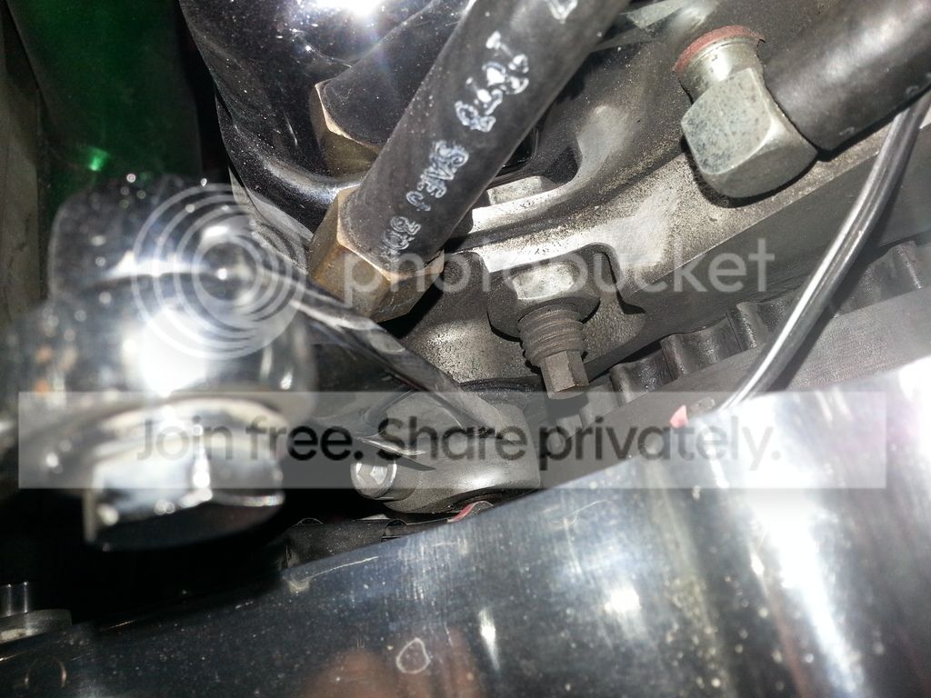

    Check this nut and see if it is loose, it is the adjustment nut for your shift forks. Don't screw around with it, just check and see if it is loose. Then check the eyelets on the shift rod, and make sure that their not froze up. Then we can go from there.

    See the allen bolt at the bottom of the shift lever, that was loose on my bike, I was having a hard time getting into neutral, tightened it up and it works great!:old2:

    Moved on to the shift pawl. The locking nut was loose. I never could get equal spring tension for both upshift and downshift directions, but set it so there was equal travel. There is spring tension against upshifting, but really none against downshifting. This operation was performed while she was in 3rd gear.

    OK, I'm a dumbass. I readjusted the shift pawl spring correctly and she shifts perfectly now!
    From the service manual:
    3. Check shifter pawl adjustment.
    (a) Shift transmission into third gear.
    (b) Move shift lever and check for the spring pressure in both directions without shifting out
    of 3rd gear. You should feel the pawl contact the drum in both directions.
    (c) Locate the shifter pawl screw and lock nut on the left side of transmission case, next to
    the shifter lever. Loosen the lock nut and turn the hex-type screw either clockwise or counter
    clockwise, until the spring pressure is the same when moving shifter in each direction.
    Tighten the lock nut when spring pressure and travel is equal and re-check when tight
    Just FYI for future searchers:
    I was mis-adjusting it because there is NO spring tension when adjusted properly. There is no 'detent' or center position feel either. The shift lever just moves back and forth smoothly, contacting the drum in either direction.
    If the pawl is adjusted too far in one direction, spring tension is felt when moving the shift lever in one direction, and the shift lever will spring back to the 'detent' position; the shift lever will then move the opposite direction from the 'detent' position without any spring tension. Hope that makes sense.
