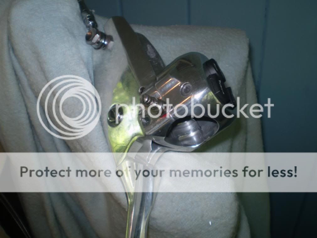

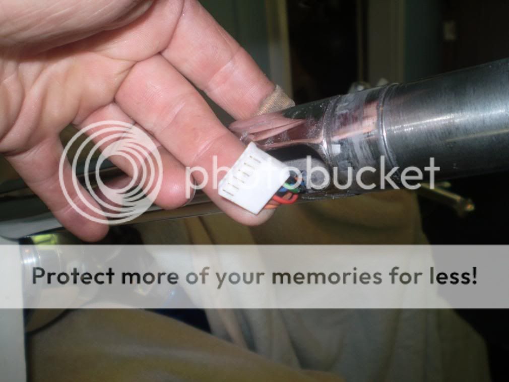

    I was not thinking I would see this till next week but hear it was when I got home today and I ripped into it ...I looked at the directions and I first thought dam this might be a bit of hassle....so I took out some tools and got started ...The directions are great and most anyone can do this ,it would help if you had some help but I work by myself most days and thought go for it ...I won't give a step my step but I will give my impressions ... First off the dredded Circuit board plug ..man they give you about one inch to play with and its a bitch but doable [​IMG]
    The Snap rings mentioned in the other How to stated you remove them DO NOT ...just do as the instructions tell you and use WD40 and wiggle they pop right off ..

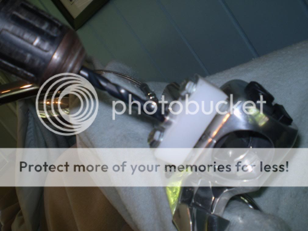

    Cover the bike with a blanket if your working by yourself! The Jig is well thought out and hell it even comes with its own Tap :up: Cool
    After getting it in place and snugging just drill away "I bit scarry" its 30 grand afterall :lol:

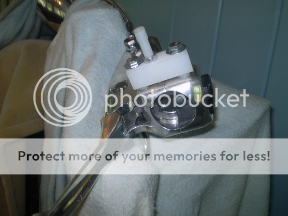

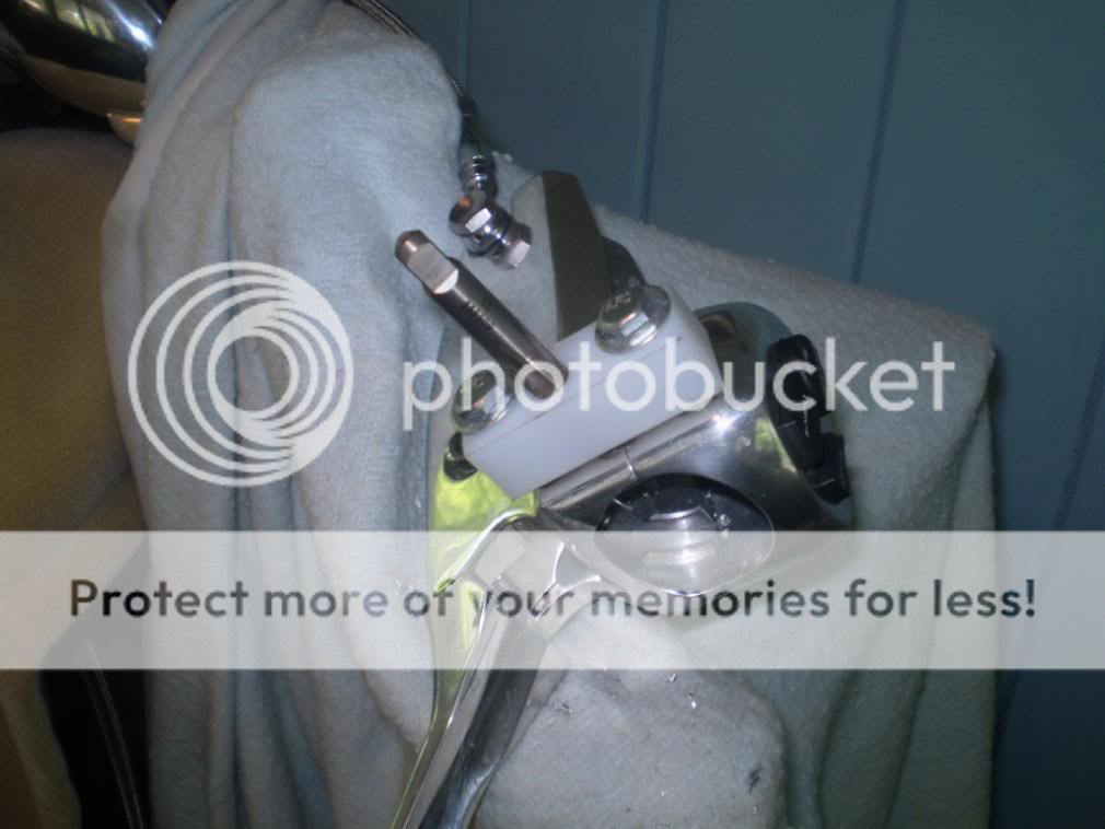

    Then use the same jig with bushing removed to tap new drilled hole
    Now you have the job half finished ,get the "Cartridge" out apply a bit of Locktite ..most of us will already have this but HELL it even comes with Locktite ...way to go Tom. screw it in ..

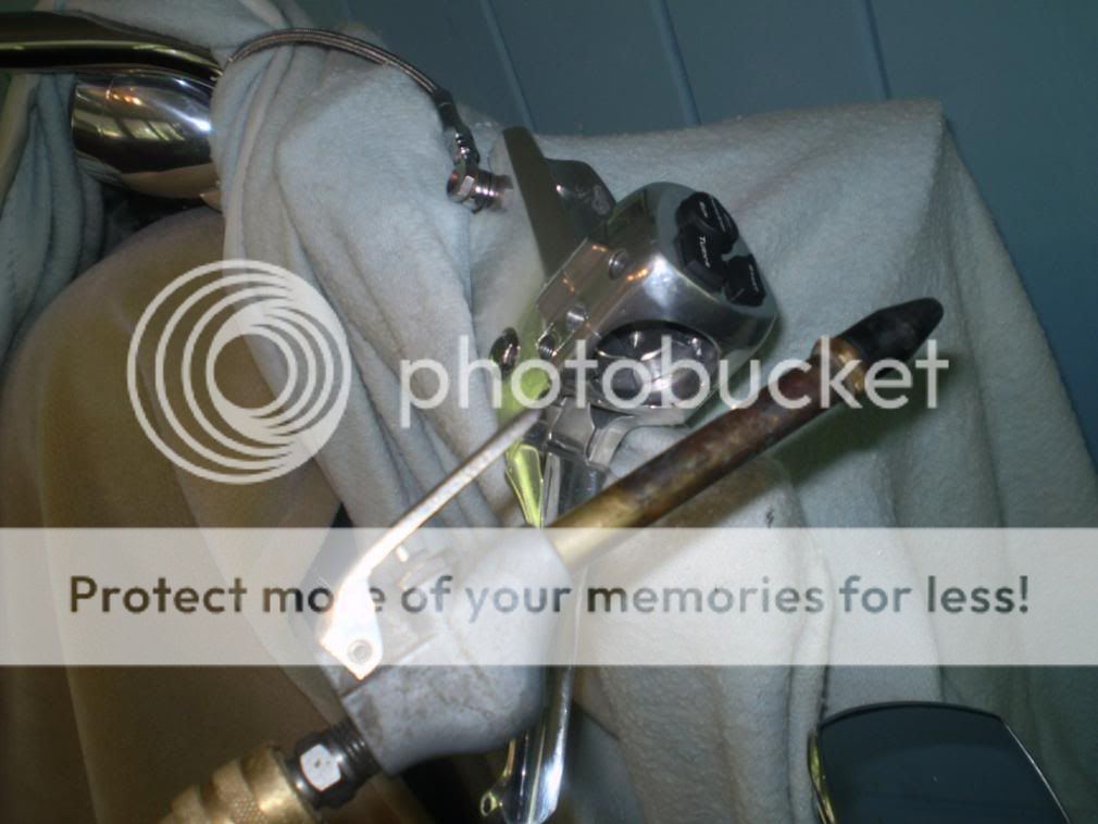

    Unbolt the half's and then the Fun begins, its Fun because you have to juggle the Master Cylinder and the cables and it would be a help to have a second set of hands hear but it can be done and it took me about 45mins total !!
    The last thing you do is install the leaver use a bit of the locktite on this screw and read instructions on how to adjust Simple !!! I wish I had this on the Myrtle ride but I will now!!! ..I still have to clean up tools ,but it works like a charm ..and looks good too.

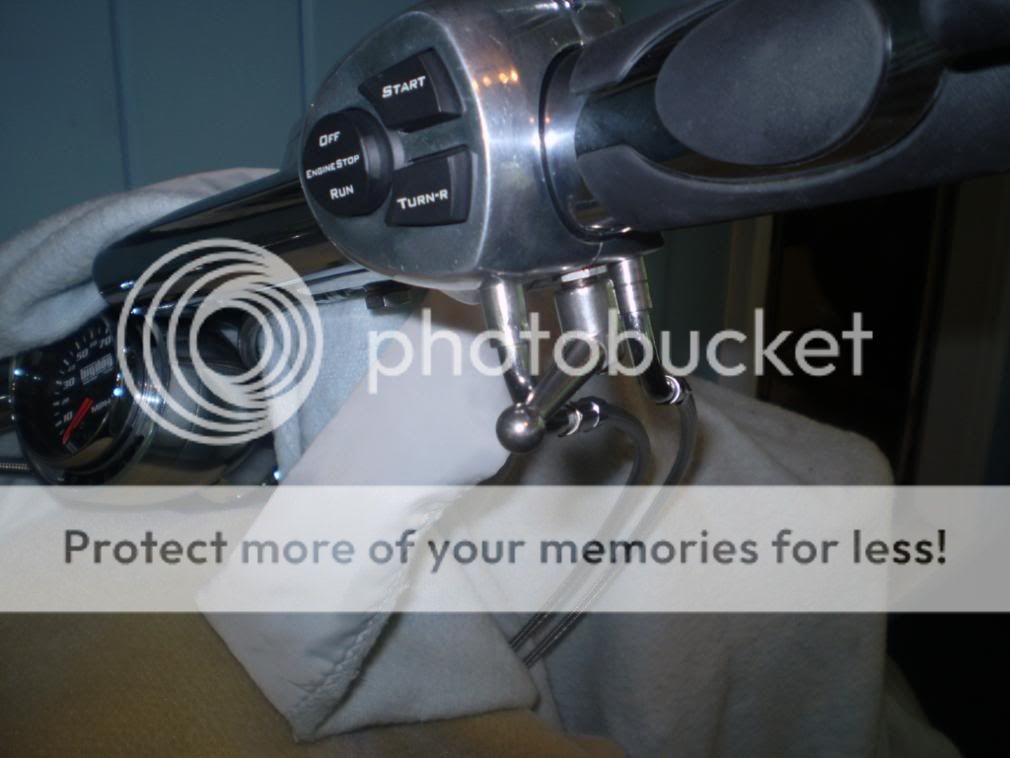

    Two Tips Clean up with Low powered air pressure if you have it if not some air in a can used for cleaning keyboards will work!
    ..[​IMG]
    Also mark the cables to make putting back easyier ...and hold off Drinking that Beer till you finish
