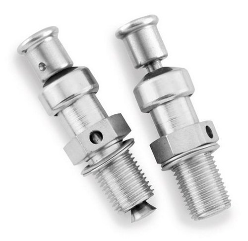

    any pics of the manual ones anywhere?

    Jims. A google search (search "manual compression releases") brings up all kinds of links and also an S&S pdf file <LINK> that shows the install.

    Broadband thanks for the links! To use the stock hole in the top of the cylinder head I believe we would use the 14mm long reach. The stock S&S has about 3/4" of threads that go into the cylinder head.

    The picture of the 2 c/r that's in the picture broadband posted WON'T work in the center of the S&S heads as replacements. :bang:
    S&S makes their own manual releases that will work. They look altogether different, and have the proper threads.
    The ones in broadband's picture have 10 mm threads. they are a little tricky to install, as there's not enough combustion chamber thickness. :confused:
    Also, metal push tops WILL burn your fingers more than you will believe, when used on a hot motor. :angry:
    John

    John won't the 14mm long reach work in the center of our heads in place of the existing electric release? I know the head would have to be machiend for the 10mm.
    Never thought about the temp on the ole finger prints though :bang:

    Yes, the metal ones will feel very hot on the fingers if you need to use them to start up a hot motor. I have seen pictures of CR's with a black knob that I assume was some kind of plastic. As far as the threads, yea, make sure they will fit before you try them for sure. The pics/links were just random google searches to give the idea of what is kinda required. Make sure you get what you need.... and will work.
