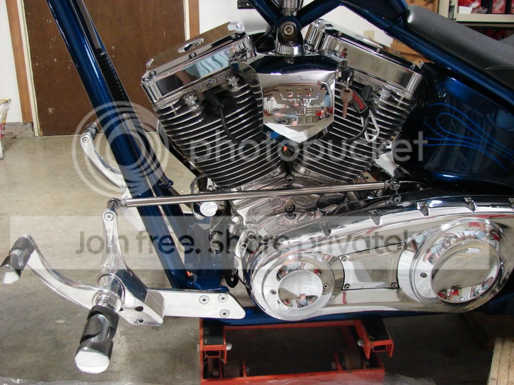

    O.K. guys, as promised, I am posting the shifter side of the extensions since we got in a time crunch the other night trying to get done before dark. I had Benny(Postman) come over for a follow up and some photos. I must admit that my perfectionist attitude has cost me some more time before I can give the master template over to Kaptin. You'll see what I mean from the photo.
    Here is the final product that I installed the other night, notice the angle of the shift petal that you must get your foot under to shift. Mighty tight ain't it!!

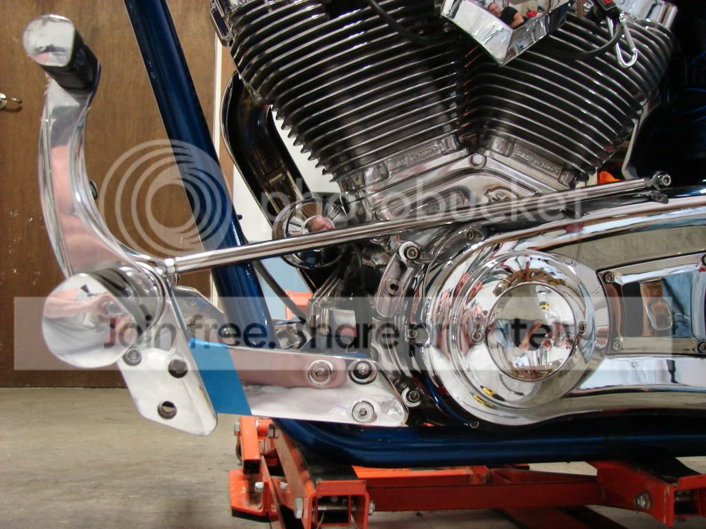

    Here is a close-up, notice that the shift petal is the same angle as it was in when it was 6" further back. But as you extend your leg, the toes start to point skyward.

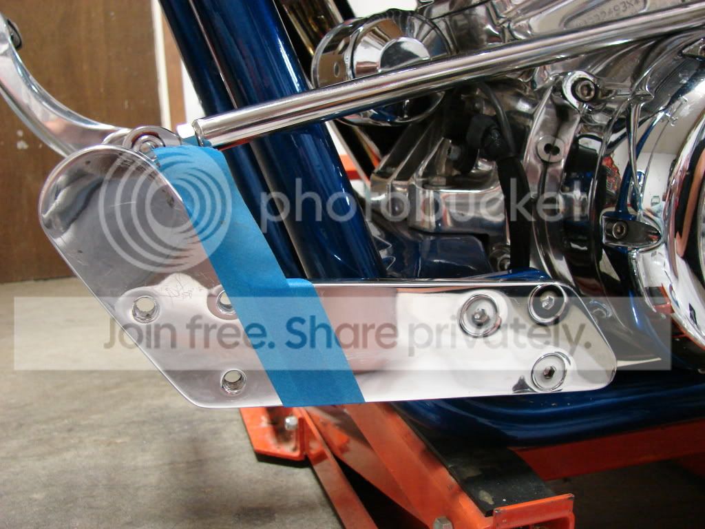

    Here is the bracket I fabricated with the shifter removed, my mission now is to "clock" the shifter clockwise to rotate the shift pedal backwards so that the now skyward pointing foot can easily get under the pedal. Blue tape marks the new angle I determined to properly align the pedal.
    Here is the shifter after being "clocked" in a clockwise direction.

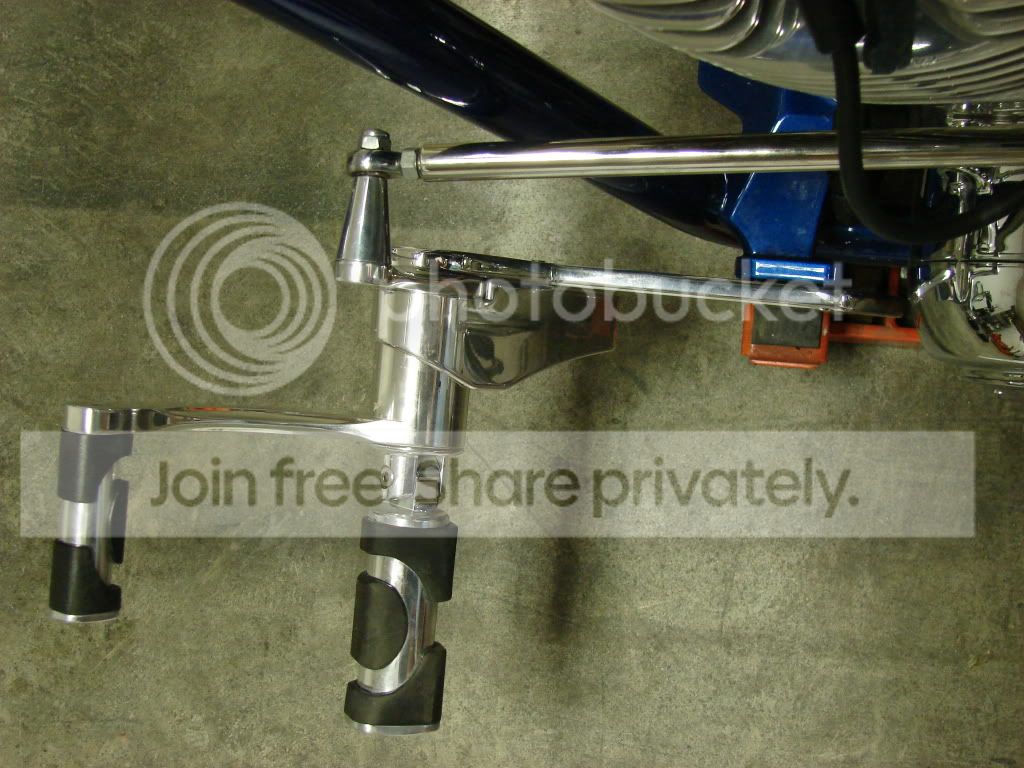

    And here is a overhead view showing the shift rod and the tight clearance. I trimmed 1/2" off the cone shaped spacer and the spacer bolt to get the shift rod to clear the frame.
