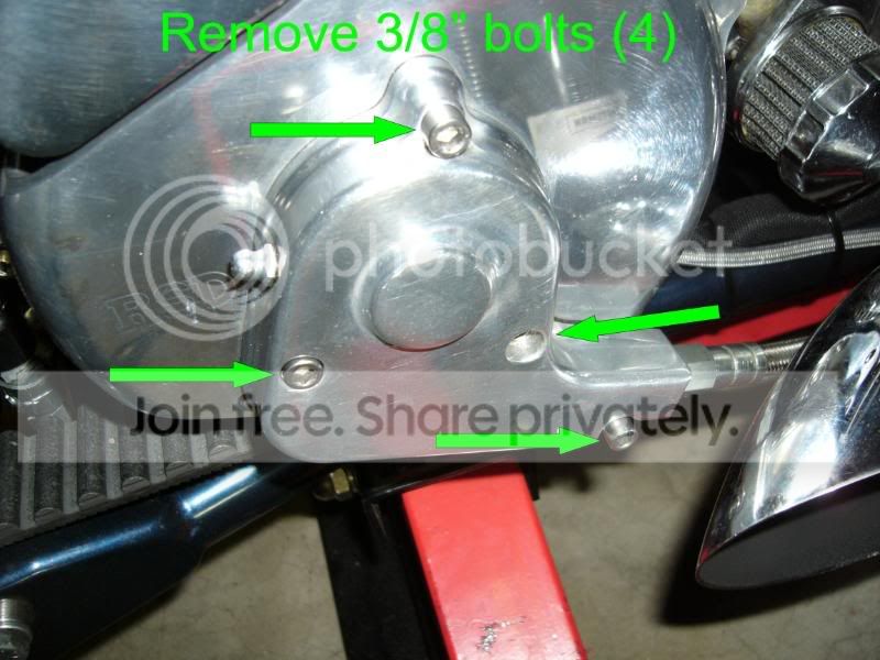

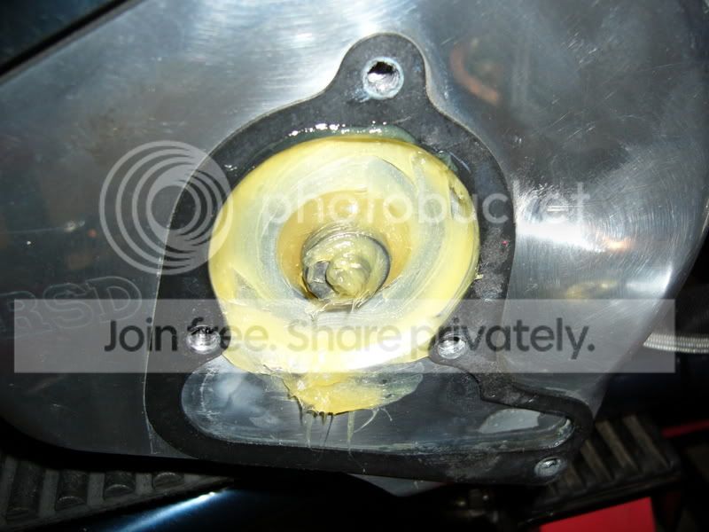

    Step one: Remove four bolts holding the clutch ramp housing to the tranny. This is where I really like my Lake Pipe -- most folks will have to remove the exhaust to get to the housing.

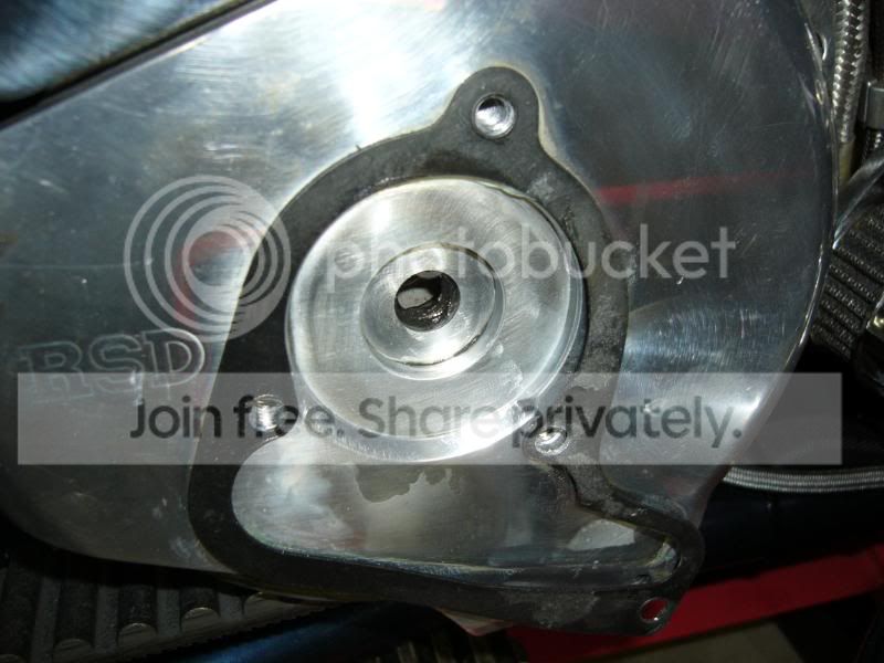

    Next carefully separate the ramp housing from the Tranny housing. Expect the gasket to have adheared to one or both of the housings. It's not a bad idea to have a gasket available just in case. This gasket just holds back grease and NOT tranny fluid, so it needs to be in good shape but not always replaced.

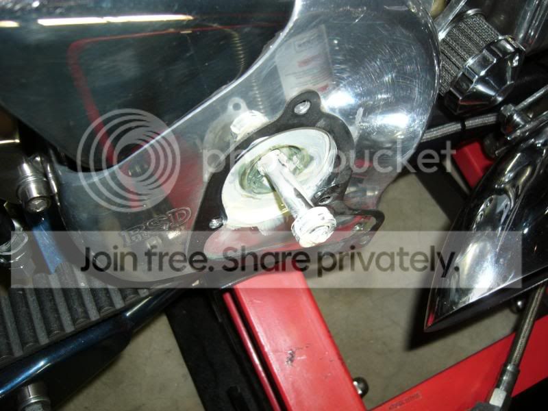

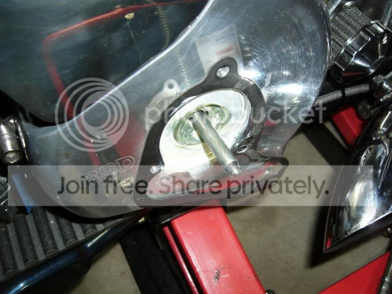

    What you will see is the first part (of two) of the clutch pushrod assembly sticking out.

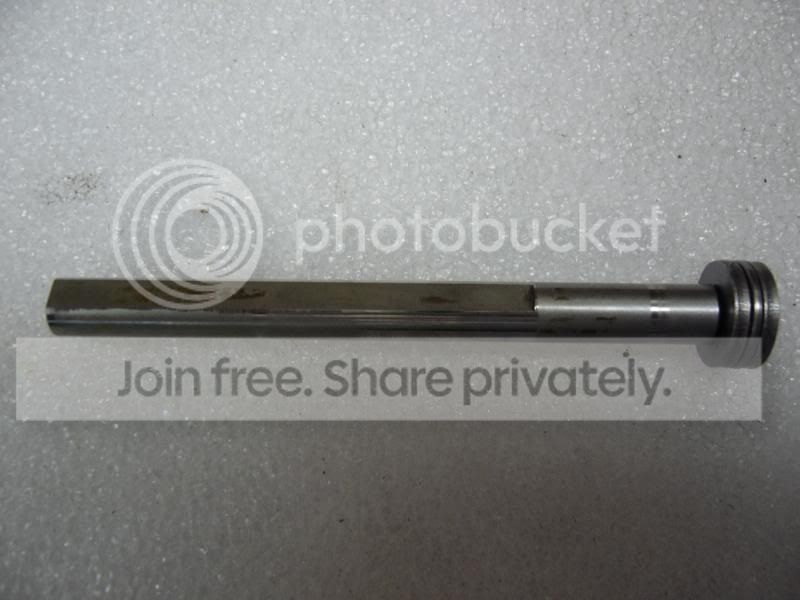

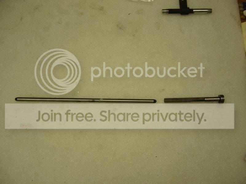

    Pulling out the first piece, brought out the actual clutch pushrod itself. I'm not sure what you would do if this did not happen! The clutch push rod is in there pretty deep, like a tampon in a tall girl, so maybe I just got lucky. Anyway, pull that out too.

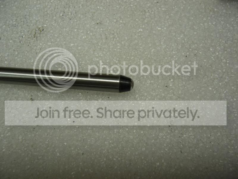

    Next clean those two parts and inspect them for wear or burn/heat marks indicitive of poor lubrication. Pay particular attention to the rounded pushrod ends for excessive wear.

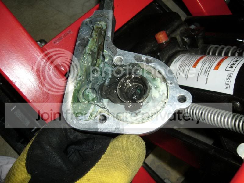

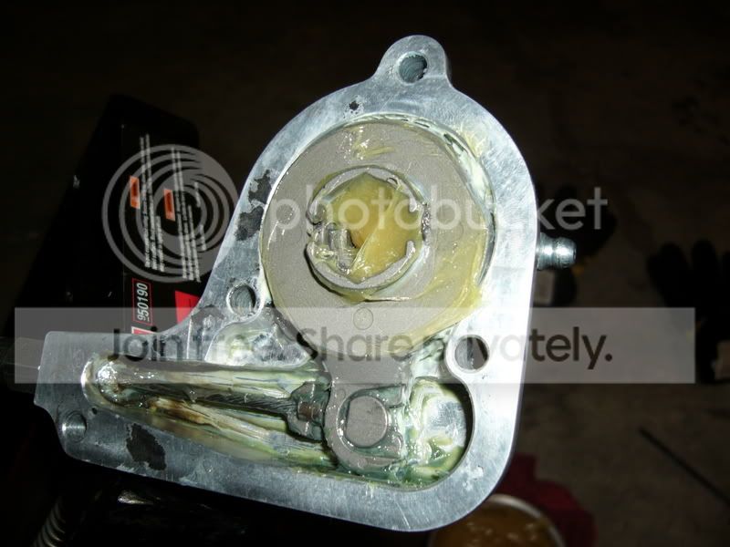

    On to the ramp assembly housing. As shown below, I'm clearly pushing too much grease into the zerk fitting. I think a better job would have been to completly remove the ramp and ball housing and clean it out completely. But, I was not prepared to reassemble it if I had a problem, so I cleaned the area out as best I could without removing the ramp.
    Next clean the housings and push plenty of Hi-temp grease down into the hole the pushrod rides in. Reinsert the two parts of the clutch pushrod assembly, button it up (bolt tourque is 7-9 ft/lbs) and you're done with that part.

    Thats great chacha!!! If that inner rod drops off put some grease on the end of the outer rod and jam it back in her and try and pic up the end of the inner rod that way!!!
