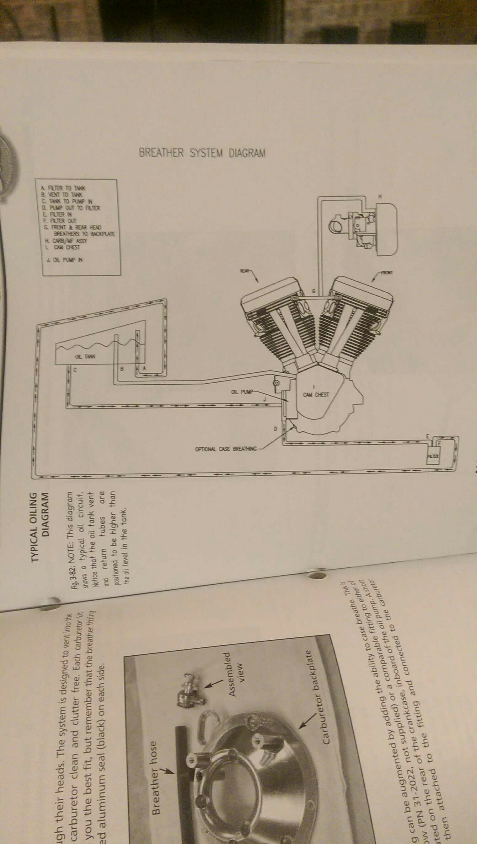

    What do you mean disconnect supply line from the sump? You mean supply to the pump?
    Oil goes in via the left side of pump and out via right side and up to filter and back to tank.
    The line going directly into the cam chest is a vent.
    Just trying to get an idea what line your talking about. I got zero oil pressure now and about to take it all apart.

    The red arrow is the line I cleaned out.
