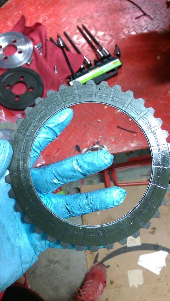

    Was just thinking, why is it that I have 12 clutch plates but all I see listed anywhere on the Baker site and ebay are 9 pack clutch replacements. Am I gonna be able to find a replacement 12 plate setup if I ever need one?
  10. Th3InfamousI
    Sep 26, 2009
    10,858
    16,079
    Texas
    04 Ridgeback & 07 K9
    yep they have 9 and 12 but you probably don't need new clutch plates. I highly doubt you do. EnergyOne made the Friction Plates they are actually a Forum Vendor you can call and get them direct if needed, but again unless you got 30k+ miles you shouldn't have to replace them.
    You wanna make sure you clutch stack height when assembled is up to spec though. If it's not then I would recommend swapping out some of the thin steel for a slightly thicker one to bring your stack height back in-line. Big Dog went to a 12 plate clutch system and just used thinner steel so they will actually wear a bit and when the stack height gets out of spec it makes these Big Dog clutches hard to adjust. Energy One is great to deal with I called them last year
    Twisted likes this.

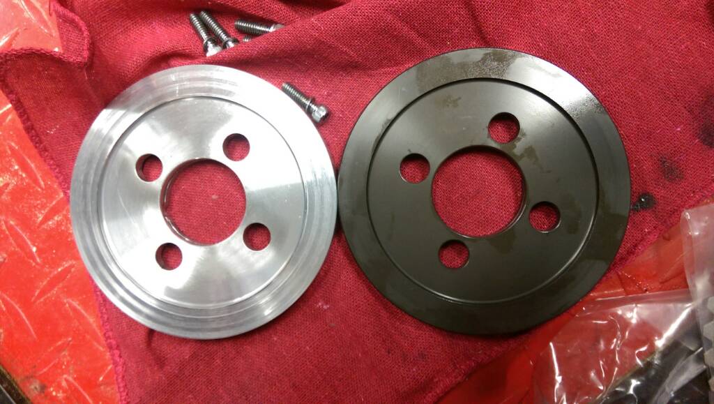

    Butch forgot to ask what does your pressure plate look like?
    Baker has a hardened upgraded pressure plate too...haha see a theme here? You want the darker one or it will wear that first friction plate all funny
    chubs and Twisted like this.

    4,422
    Hazlet, New Jersey USA
    2005 Big Dog Chopper
    Butch
    Lmao, yeah I have the nice bright one on the left. Pretty bad that they have to keep upgrading their parts to what they should have been in the first place. I'll take a closer look at mine to see if it's at all worn. If it is then it will seal the deal for the bandit assembly. Otherwise the bill for Baker it gonna outweigh the price of the bandit. Gotta love it! Now stop thinking of shit to empty my pockets.

  14. Th3InfamousI
    Sep 26, 2009
    10,858
    16,079
    Texas
    Take your finger and you'll feel the ridges worn worn into that plate
