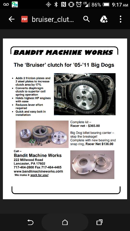

    Texas
    04 Ridgeback & 07 K9
    I was just looking I'm not sure this price is accurate but you can buy the bandit carrier alone for $136? Don't need the whole getup
    Viking, chubs and Marky-Marc like this.

    the carrier is available alone I think, not from Baker, but maybe from Bandit.......reuse your old clutch pack etc.....I'd replace the clutch hub nut though too while you're at it with a new one.....
    The whole assembly with inner carrier is around $400 I think....
    chubs likes this.
  18. Th3InfamousI
    Sep 26, 2009
    10,789
    15,973
    Texas
    I'm gonna call Bandit today and see if that price is accurate. That's why I am mentioning because Baker is really proud of their carrier comes with the inner hub and carrier is $400...ouch.
    Inner hub is $125 and if the bandit is $136 then you are out the door with all good parts for $260 instead of $400.
