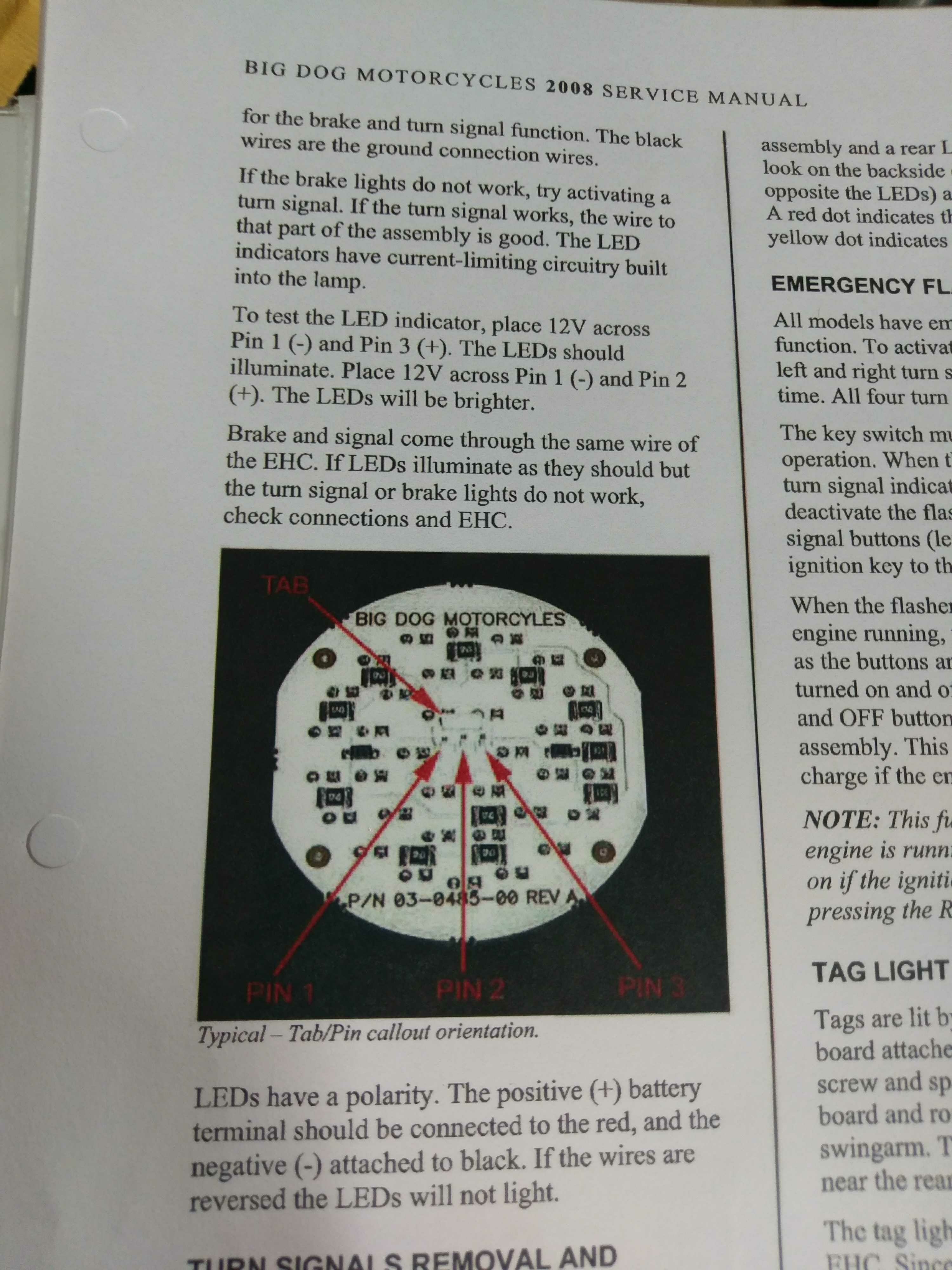

    First time seeing this thread..should have measured voltage on Turn signal wires and power wire before buying these LED.
    Power wire has plus +12v for runners and turn signal wire will have +12v when brakes are hit or ittemitant signal for turn. They use the same wire. So either born the front and rear brake switch are bad or the EHC crapping out on ya.
    Great diagnostic write-up in the manual
