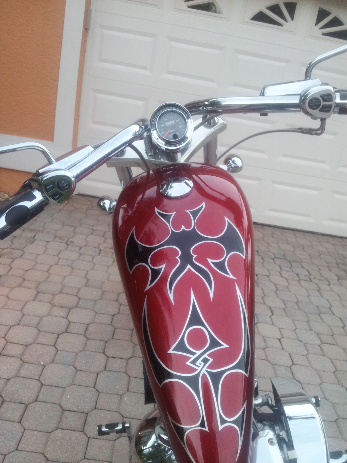

I was thinking it might be handy to have a database of color codes with a picture of said color...
Please add pic and codes for future use...

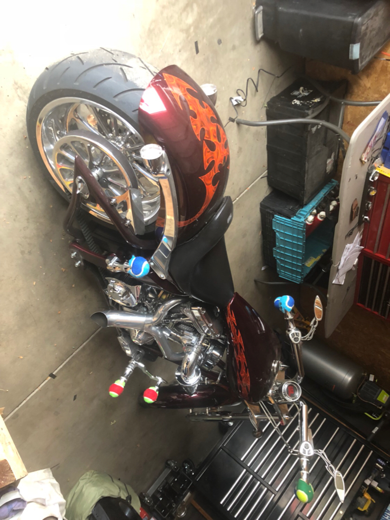

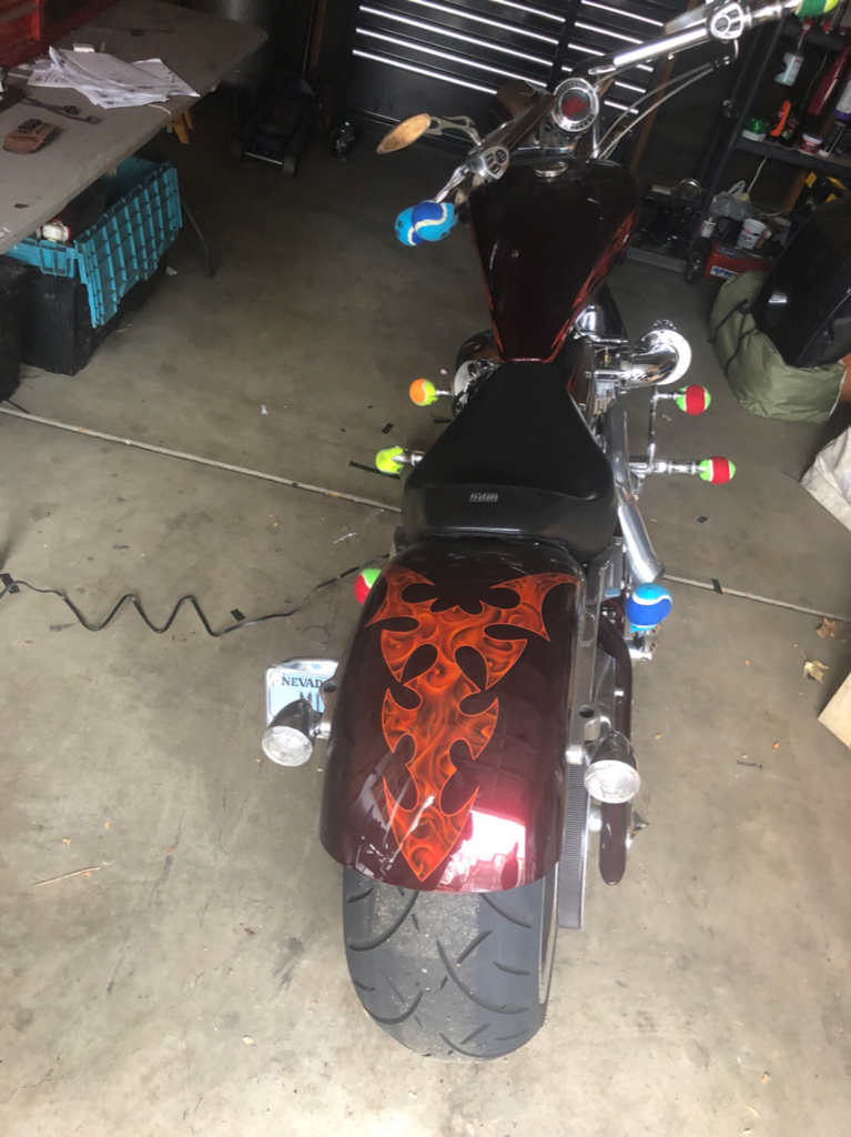

Where do I find the specs for my paint info? I have taken it to several shops and no one can come close to even matching just the main paint.
Gmutoagrsv
I was a complete idiot. I was messing with the right grip. I put it back on with the cables too low so it hit the tank and took a chunk out.

from what i can see of the pictures, they are the same color. if i am right, they look like House of Kolor Black Cherry Kandy (base coat is BC-10) with a top coat of UK-11. if you can't find the paint, what i have for an alternative is:
(Fake Black Cherry)
base coat weight
DMD 1606- 326.9
DMD 1683- 420
DMD 646- 442.6
DMD 1605- 464.4
(prl)PRL 99- 471.5
PRL 96- 476
DBX 1689- 508.7
disclaimer: i am not a painter and just passing this info on, so take it with a grain of salt. GOOD LUCK

I went to a Ppg place and a house of colour. The brought several of their paint samples and weren’t very close. So don’t get your hopes up too high. Lol.

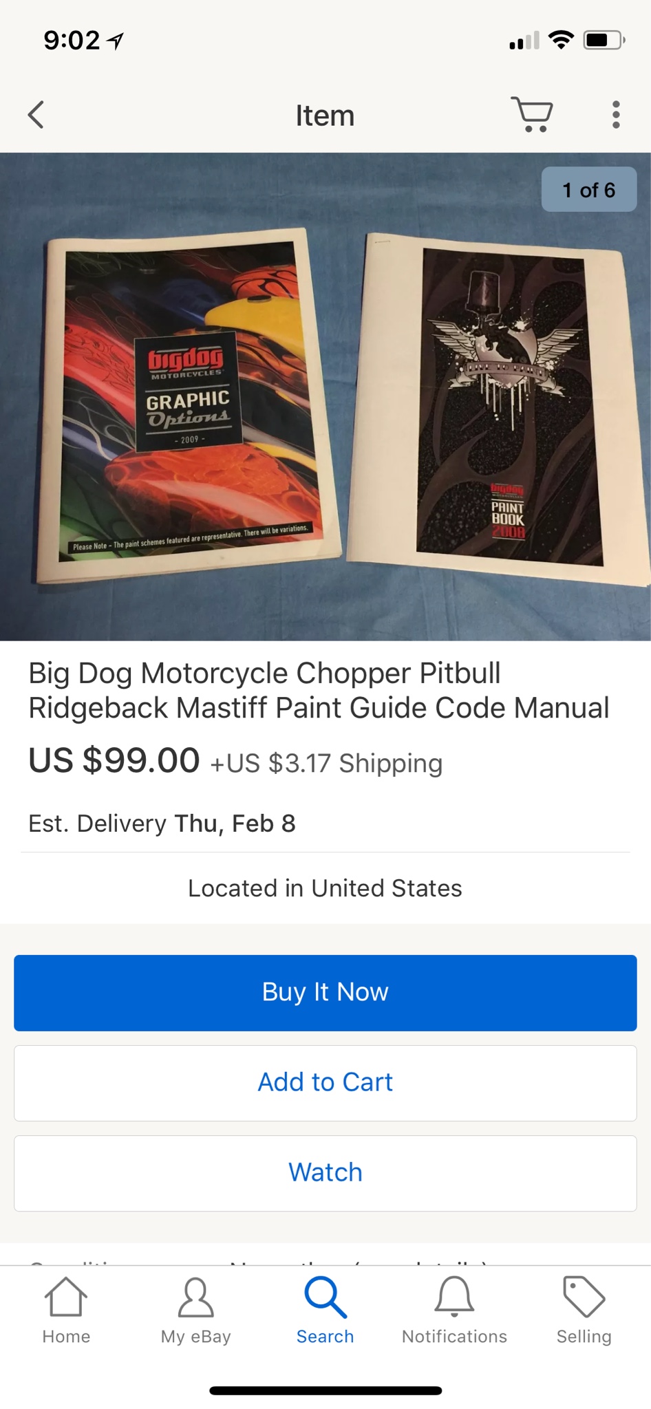

I’m down. I don’t care about the hard copy. But would be happy to scan it all. So far. Unless anyone else wants in its 50 each.

Just a heads up not sure If that's all years or not. kinda hard to tell first pic shows 2008 paint codes, then there's some three ring binder but not sure what years.
Mike manson
I got message in now for what yrs it covers got him down to $85 free ship
