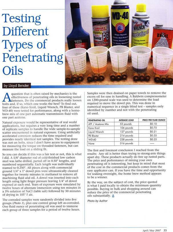

    Well this was interesting I thought! Gonna have to start mixing my own shit!
    Otherwise I'll also be ditching the PB Blaster for the Liquid Wrench.

    Interesting..wouldn't want to be using an acetone mix tho..

    I've got to replace some ujoints on the truck this weekend this is why I was looking at it. I'd have no problem mixing acetone and ATF and putting it on the steering knuckle bolts.
    However you need a metal Can to mix/store/spray. The liquid wrench was interesting though.

    Interesting post Eric. noticed you can read the article too. Cool methodology.

    Yes... I like to make sure I have credible sources.
    I saw the post on about 80 different forums but it seemed suspect I wanted to find the original article it took awhile. Didn't want to be caught with my pants down not a great look.

    Yea, that an old time recipe. Works really good. If I have some really rusty bolts, or a broke off stud in an exhaust manifold I'll mix up some of that. I mainly use PB Blaster, and thought it was the cats meow, but I found some spray made by Shaffer's that's even better.
