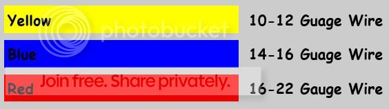

    Color Coding: All of these connectors are color coded to reflect the wire sizes they are meant for.
