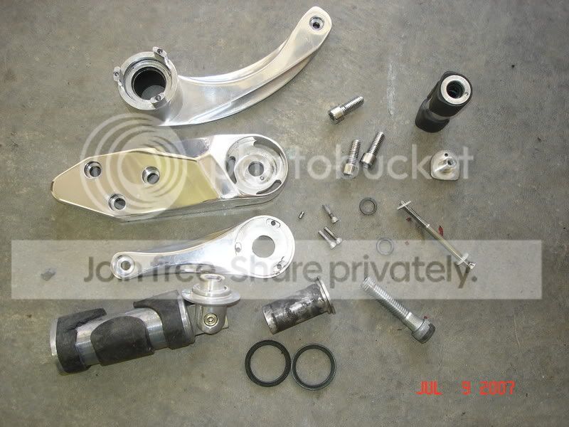

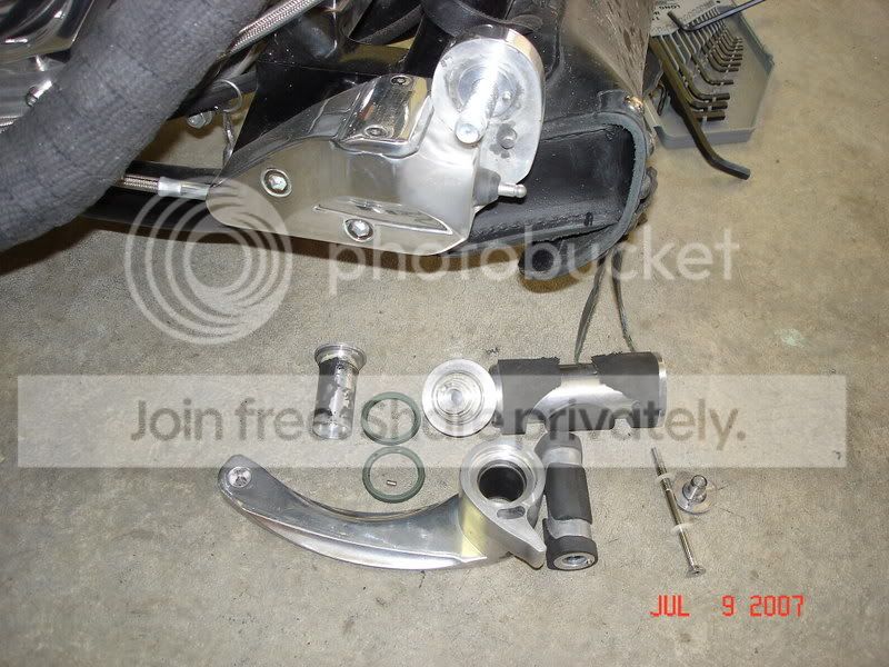

Won't say you can't do it but you can't do it cleanly. On the shifter side the whole BD piece is replaced not just a flat bracket behind it. On the brake side there is a plate behind the master cylinder unit that gets replaced with the extended kit. I've had the extended kit since I got the bike and it's way more comfortable for you long legged SOB's. :D
This is all of the pieces on the shift side. No plates to replace like the JBrake unit.
And this is the brake side and behind the master cylinder is a plate but it's specific to BD.
You could use the JBrake stuff that is a great product but you would have to replace about everything involved in the controls.
