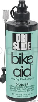

    I just had this discussion with him a few weeks ago he lubes the cable twice a year with Dri-Slide Graphite Cable Lube.
    For most of us that don't put as many miles on he does once a year should be sufficient. Clean out and repack the ball and ramp with some quality grease and lube the cable.
