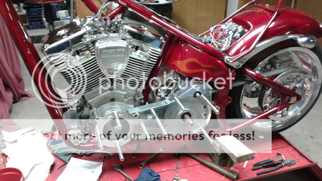

    Shocks, starter, oil tank, and some more of the primary.

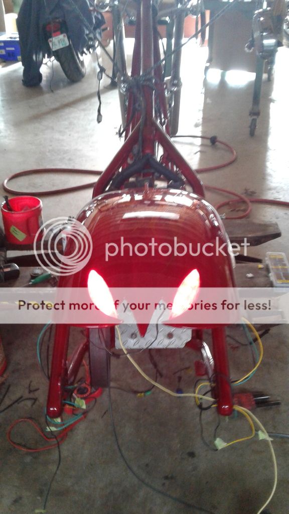

    Whats going on with all the relays? Didn't realize you had it really hard wired

    Yea, when I first got the bike, I was building it for someone else. The wiring was all hacked up, and the cheapest way to get it running was to hard wire it. All my switches on the handle bars ground the relays.

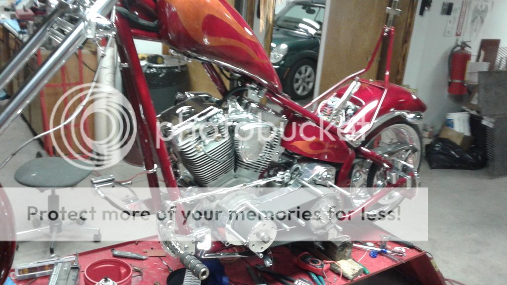

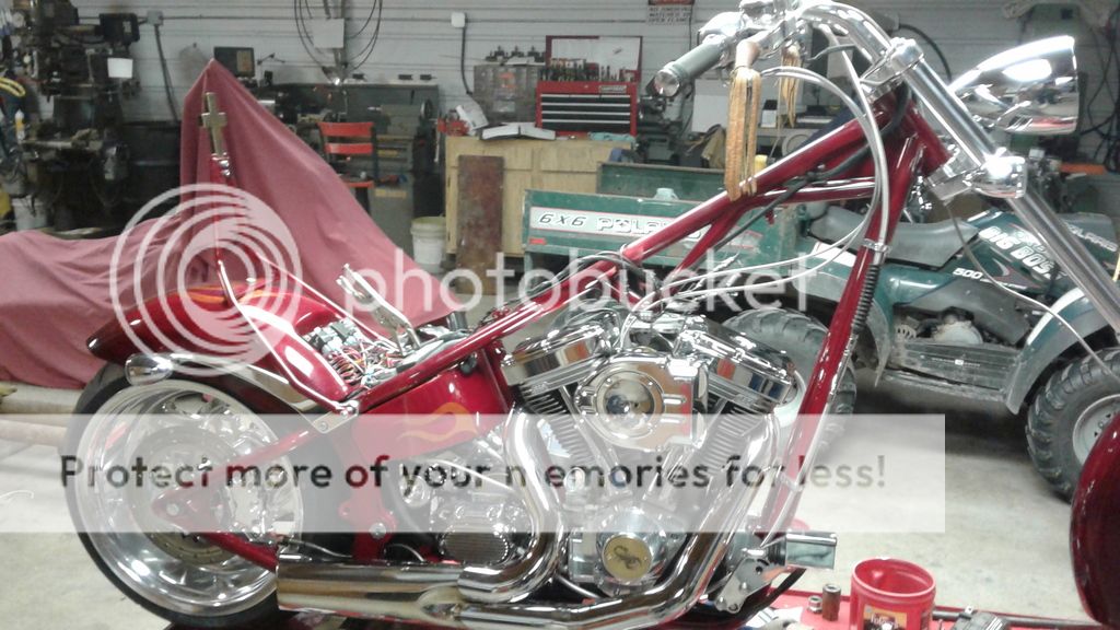

    Other than the foot peg, the right side is done. oil and battery are in.

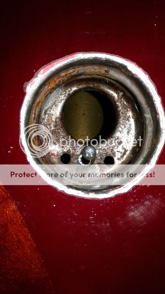

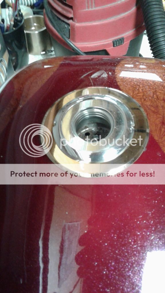

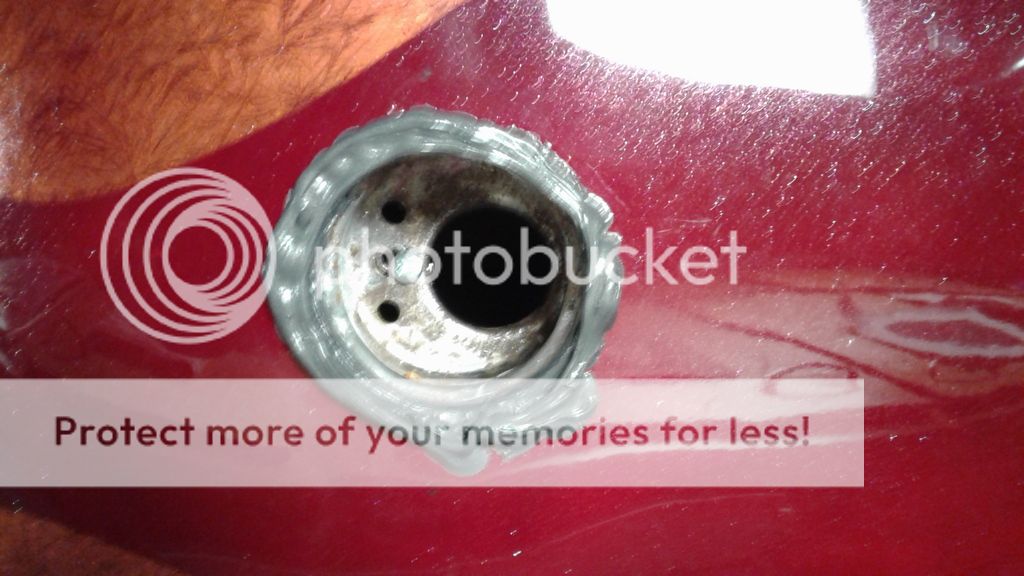

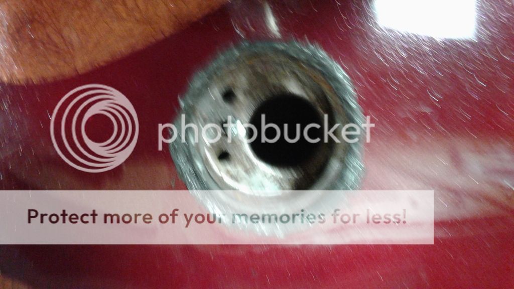

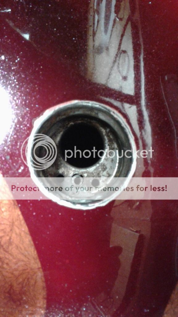

    I thought some would like to see the proper way to install the paint saver ring.
    First before removing the tape out of the hole, I trimmed the paint back to bare metal. After removing the tape I noticed that the vent tube had come loose from the neck.
    Welding it wasn't an option at this point, so I drilled a small hole next to the tube, and put a screw in it. Which I managed to drop in the tank, 3 times.
    Sorry this picture is blurry. What it is, I sealed the edge of the paint with black silicone, and let it dry.
    After that is dry, I added a 1/4'' bead around the hole.
    And installed the ring and paint saver. Torque spec is good and snug. and wipe off any excess silicone that squeezes out.
    After that dries, at least 24 hours, you can install the gas cap.

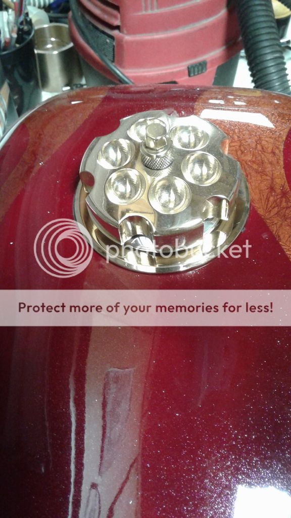

    Well wait a minute! Can I get one of them gas caps ???

  14. DrRx
    DrRx 2007 Bulldog/2009 K-9
    Jun 5, 2016
    288
    573
    Aransas Pass, texas
    DOC
    Hey where did you get that gas cap? That's awesome.
    DrRx- "DOC"
    2007 bulldog/2009 K-9
    chubs likes this.
  15. Mr. Wright
    Mr. Wright Guru
    Aug 27, 2012
    8,230
    12,004
    Salem, Missouri
    Shannon
    I'm a machinist by trade. It's suppose to be a revolver cylinder, .75 cal. And no I'm not making anybody else one.

    Got quite a bit done this weekend in between OPS. All I have left is polish out the front wheel, bleed both the front and rear brakes, right foot peg, adjust drive belt, fire it up to check clutch adjustment, and put the outer primary support bearing plate on.
    Seat is almost done too. I'll still have to make a bracket for the back rest. And remount all my bags.
