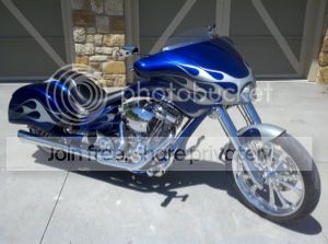

    Thanks for the comments on the looks:D
    The first picture is how it looks now.
